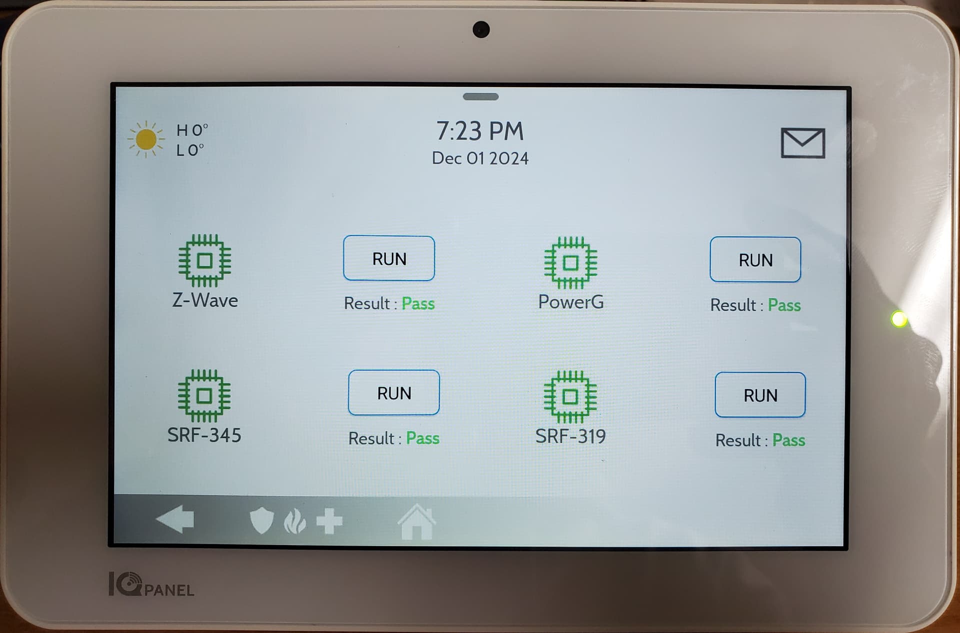

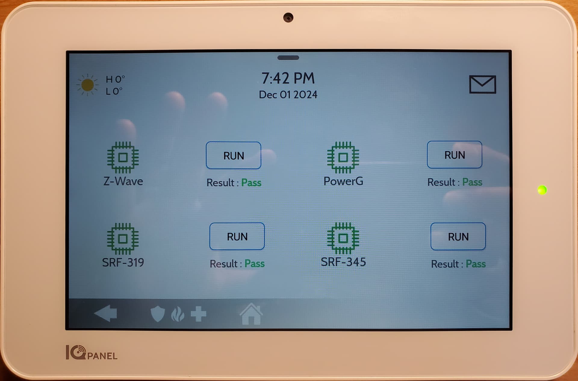

yes, that is correct. Here are a few picture that I captured before the upgrade.

Qolsys representatives confirm that the ability to use both the 319 and the 345 cards at the same time was never intended and would be considered a bug. As such there doesn’t appear to be any documentation on which firmware removed the ability to use both in the manner described.
Unfortunately without the ability to test, I could not say which FW version wouldve caused that.
