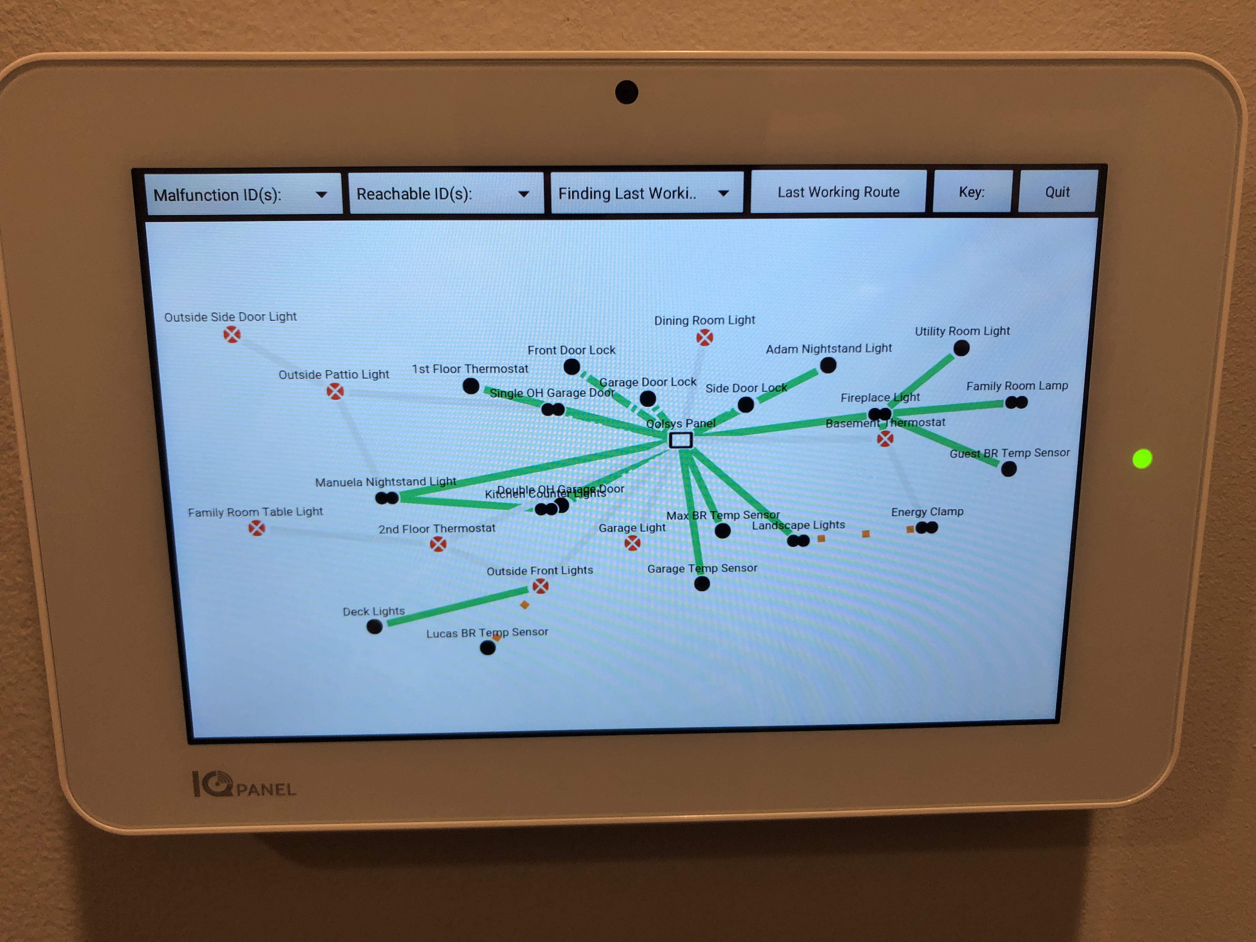

I believe I must be having the same issue, I have some switches that randomly stopped working (including a Qolsys bulb). It originally was constrained to a single bulb and the problem coincided with a power outage where the power came on/off several times…so I suspected that perhaps the one Z-wave bulb was damaged and forked over the ridiculous $$ that Z-wave bulbs go for, only to find the same exact problem. I can add the device to the network, it just never works and fails on any network discovery.
