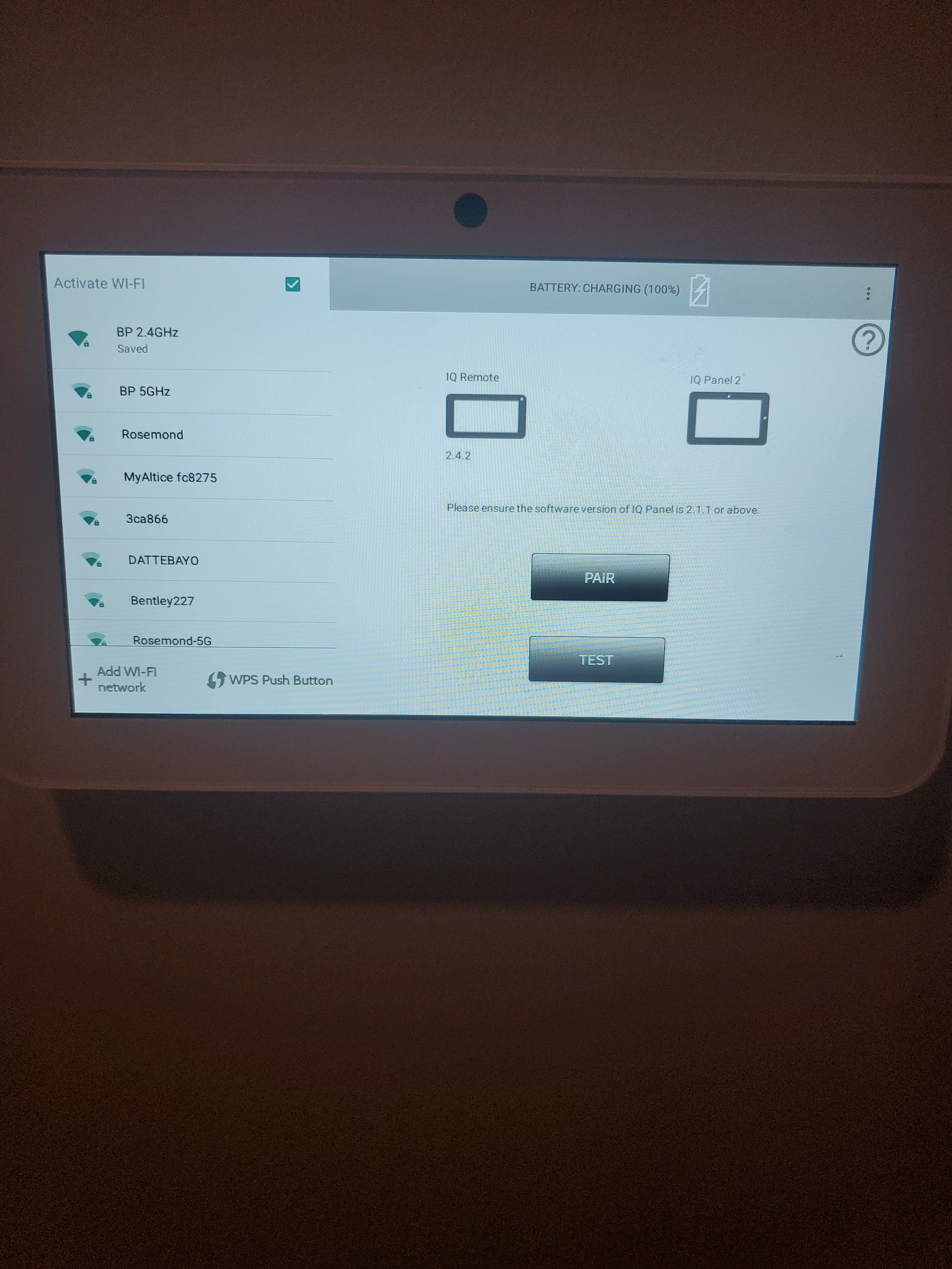

I am having a similar issue. Main panel is connected and working. Remote panel alternates between Saved, Authenticating… and occasionally Connecting… I don’t think I have see Obtaining IP address. It flashes these very quickly every few seconds, but never connects. I have tried with both 2.4GHz and 5GHz. I have power cycled, and tried the Master Reset with no change. My Wi-Fi is on a Ubiquiti Unifi AC HD access point.
If you are having an issue connecting them via your wifi network please try the Access Point mode on the IQ panel 2+ and use that to connect the IQ Remotes. This will isolate them from the normal wifi.
Did you master reset the Remote or the primary panel?
If you haven’t Master Reset the Remote, do so now, otherwise, then triple check the network key you are using for potential typos, O/0 flip flop kind of stuff.
If you never power cycled the primary IQ Panel 2+, do that now. Use the Reboot Panel option under Settings > Advanced Settings.

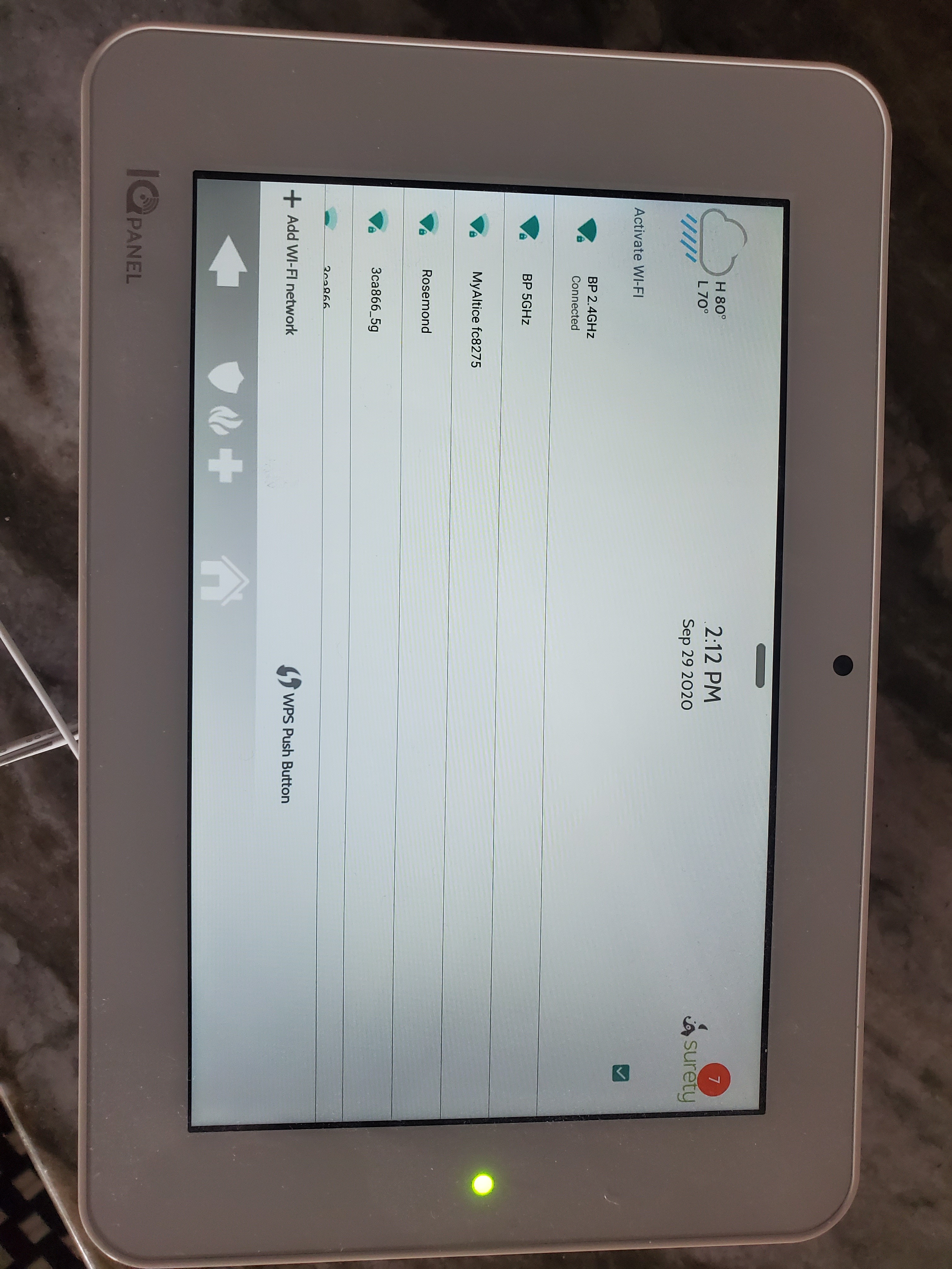

So I did the master reset on the remote (again) and power cycled the primary panel. I was able to get the remote to pair with the primary, but I am confused now. I am on a screen with only two buttons; Pair and Test. If I hit test it says to press test button on the primary. Where is the test button? Also now that the primary is in access point mode, it complains that there is no Wi-Fi connection. ls it only talking to the remote and not my Wi-Fi network. How does this work? What should I do next?
Access point mode is available at the same time as wifi. This would mean you have wifi disabled or disconnected. Go to Settings > Advanced Settings > Wifi.
You still need to pair the Remote to the Primary as a Wifi device.
On the Primary panel go to Settings > Advanced Settings > Installation > Devices > Wifi Devices > IQ Remote Devices. That is where you will find the Pair and Test buttons on the main panel.
Sorry to be such a noob. I was able to pair the remote to the main via access point mode, but I have never been able to get the main panel to connect to WiFi once I turned on the hotspot. I have tried both 2.4 and 5GHz. It shows connecting… and saved. After a while it only shows saved. It then complains about not being connected. I am positive the password is correct. I have about 12 other devices all working perfectly on WiFi. At the moment both panels are in the same room as the AP. Are there any logs that can show me what is happening? I have been a network engineer for 30+ years and I know my way around linux and switches/routers.
Detailed debug logs aren’t visible on the panel, but panel debug logs can be sent to Qolsys by us, but that requires your system to be activated in Alarm.com. I wouldn’t anticipate any bug causing this, my guess is it is a setting issue.
Are you using WPA/WPA2?
Do you have MAC filtering turned on?
Are your 2.4 and 5 networks on unique SSIDs?
