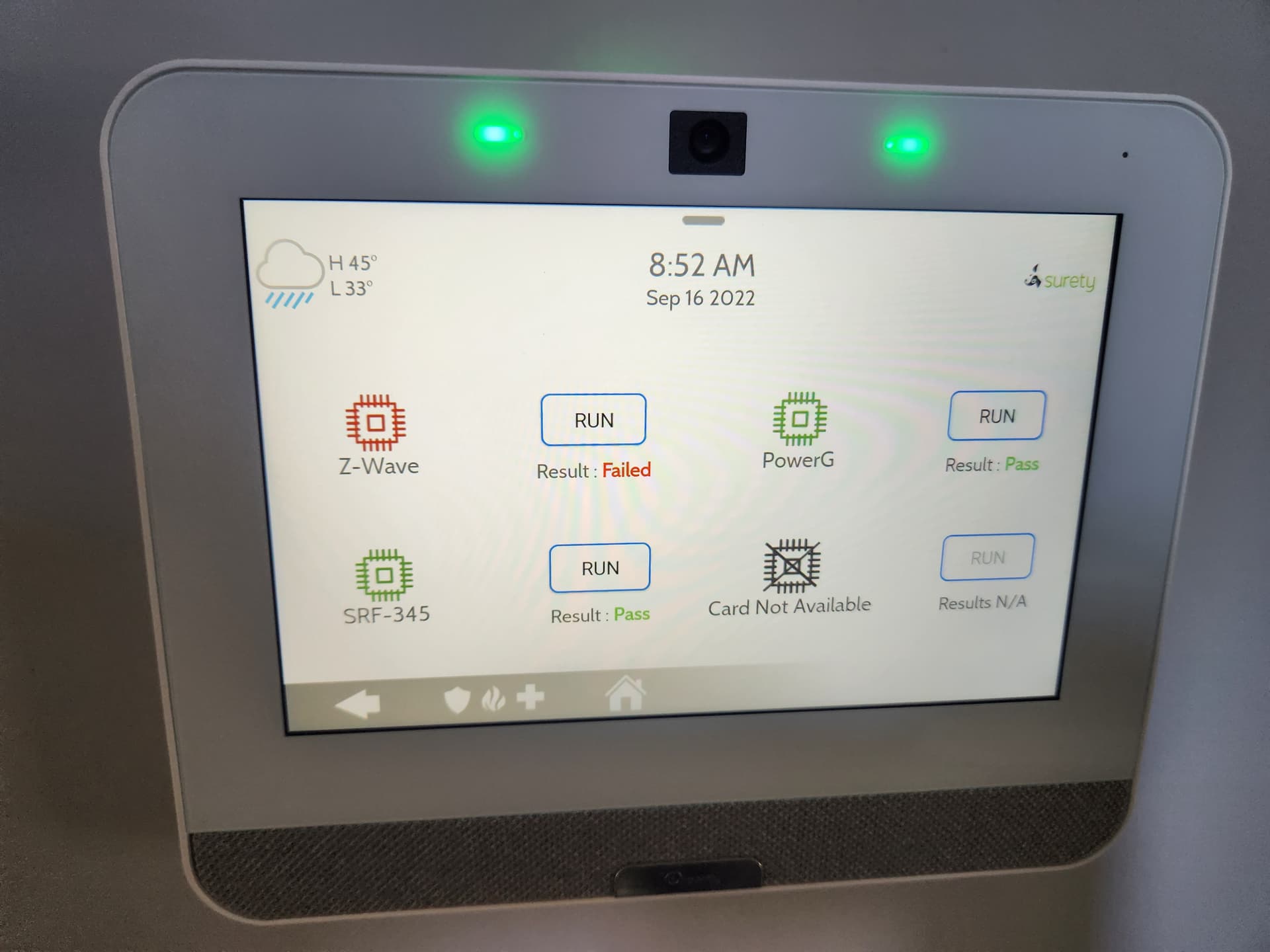

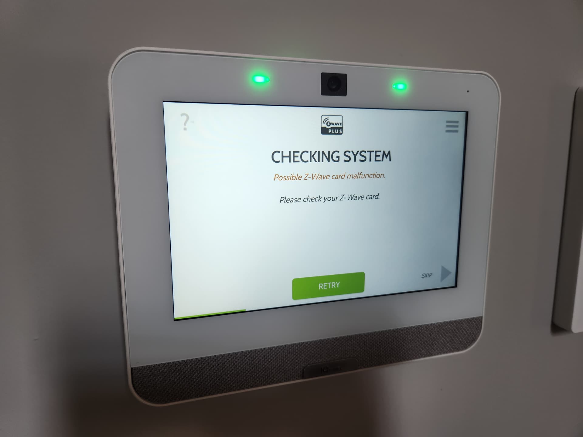

Card fails:
Do a complete power down of the system.
Settings > Advanced Settings > Power Down
Unplug power supply from the wall outlet
Open the panel and disconnect the internal battery
Leave system off for 5-10 minutes
Power up battery first, then power supply, wait 5 minutes then run the daughter card test again. What is the result
