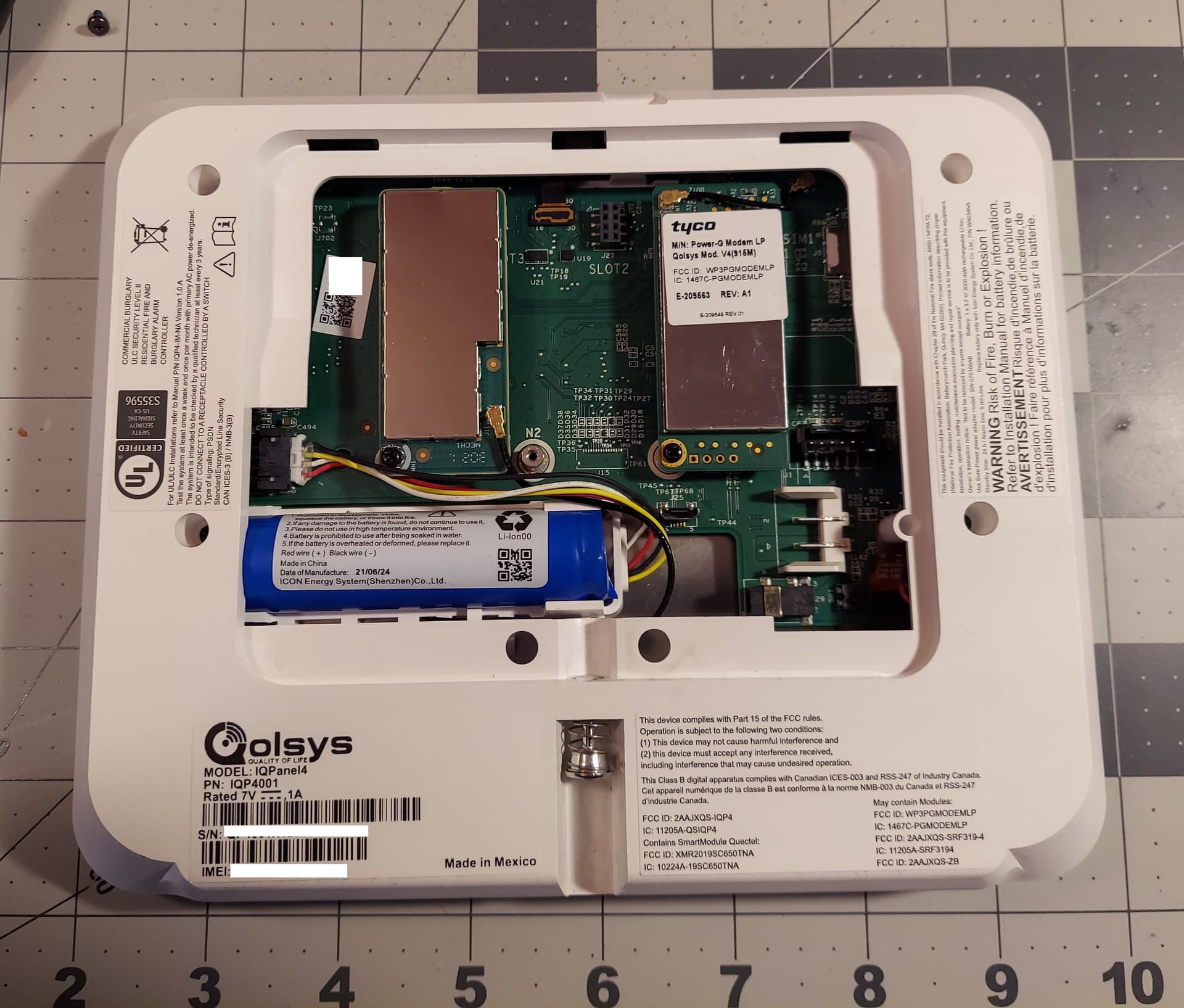

You can confirm physical presence of the PowerG radio by powering down the panel completely, removing the panel from the back plate and looking at the control board. You should see two cards installed, the one on the righ side (if facing the below orientation) should read PowerG.

I dont have a video but there is a single screw at the bottom edge of the panel that holds the panel to the back plate. See the previous image for its location. Undo that screw then gently lift up and out on the panel.

Could you provide the part number from the back of the unit? Its directly under the Qolsys logo above the barcodes on the previous image. On occasion we see some specific dealer variants.

I cant say that I’ve seen an IQ Panel 4 from that dealer/home install program before that didn’t have the PowerG card installed. Based on what Alarm.com reports, you likely have an IQP4001 model of panel, just without that powerG radio.
Installing the card is pretty easy, just make sure the panel is fully powered down, including the battery. Here is a guide on how to power cycle the panel fully:
Make sure the pins line up with the connector before seating the card and adding the small set screw.
