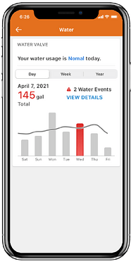

To view past water usage details using the Alarm.com mobile app:
  1. Log into the customer app.
  2. Tap Water.
  3. Tap on the usage bar for a particular date to view the water usage for that date.
  4. Swipe to view water usage for earlier dates.

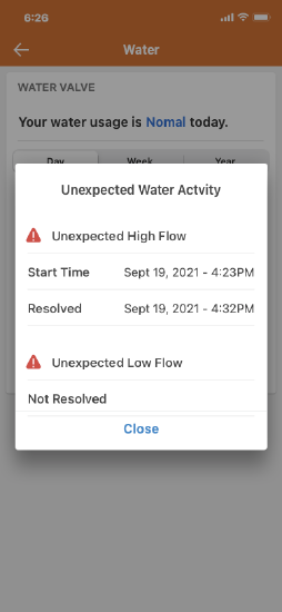

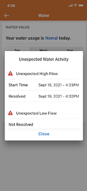

Is it possible to view unexpected water activity?
Yes. It is possible to view Unexpected Water Activity using the Alarm.om mobile app.
  2. Tap Water.
  3. Near the ! Warning Icon, click View Details
  4. In the Unexpected Water Activity pop-up, unexpected water activity events can be viewed by category.
