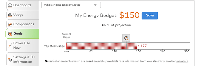

Goals
The Goals screen shows the amount of energy your selected meter is expected to consume this billing period, the amount it has consumed so far this billing period, the energy your selected meter consumed last month, and finally the amount it consumes in an average billing period.
Information on the last month and an average billing period will not be shown until enough data has been collected. Based on that information you can click and drag the slider towards the top of the page to set an Energy Budget for the month. When you are comfortable with your budget click “Save”. This will display your Energy Budget when viewing “Usage” and “Comparisons”.

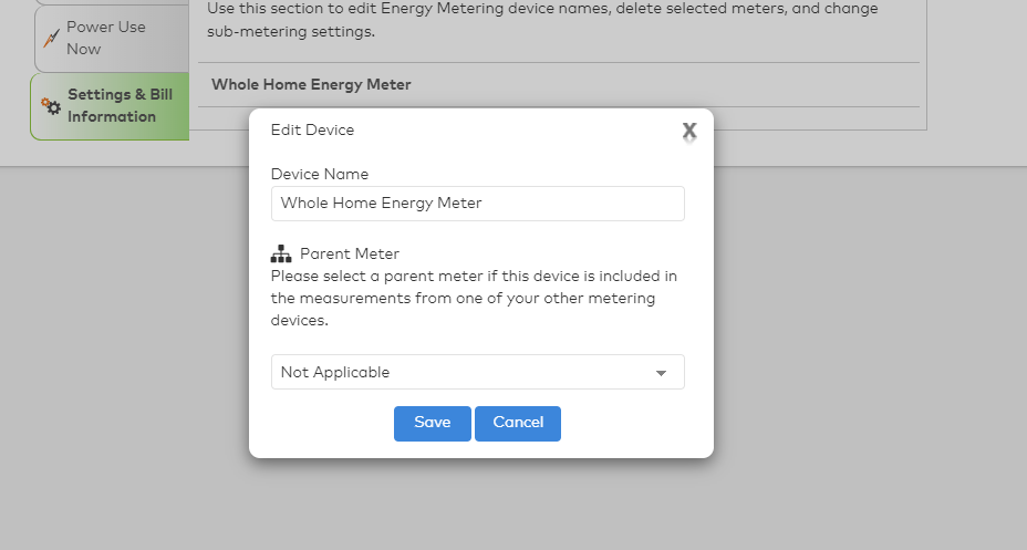

Set up sub-metering (create at least one child meter)
Energy Monitoring Appliance Modules can be set up as child meters to utilize their full potential. Child meters are meters that have their energy usage accounted for in another meter (known as a parent meter).
The following is an example setup:
  • Whole Home Energy Usage - Measured using Aeon Labs Home Energy Meter (parent)
  • Refrigerator Energy Usage - Measured using Jasco Energy Monitoring Appliance Module (child)
  • Entertainment Center Energy Usage - Measured using Jasco Energy Monitoring Appliance Module (child)
Since both the Refrigerator and TV are using electricity in the home, their energy usage accounts for a subset of the Whole Home Energy Usage. As a result, in the example, Refrigerator Energy Usage and TV Energy Usage are both children of the Whole Home Energy Usage.
To set up relationships between metering devices using the Customer Website:
  1. Log into the Alarm.com Website.
  2. Click Activity .
  3. Click Energy Usage .
  4. Click Settings & Bill information .
  5. Click Manage Energy Devices . Use this section to edit Energy Metering device names, delete selected meters, and change sub-metering settings.

Set a goal for at least one of your meters
To set a goal using the Alarm.com Website:
  2. Click Activity .
  4. Click Power Use Now .
  5. Select the whole home meter from the dropdown menu.
  6. Click to drag my goal to adjust goal as needed.

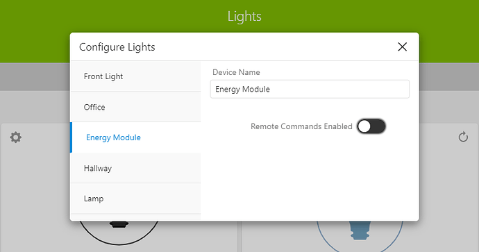

Disable remote commands
There are certain appliances in the home that users would not want to accidentally switch off but still monitor the energy usage of (e.g., a refrigerator). In this case, disable remote commands for those Energy Monitoring Appliance Modules.
To disable remote commands for devices using the Alarm.com Website:
  2. On the Home page, click the > on the lights card.
  3. On the device to edit, click the Settings Gear
  4. Click the Remote Commands Enabled toggle switch to disable Remote Commands.
