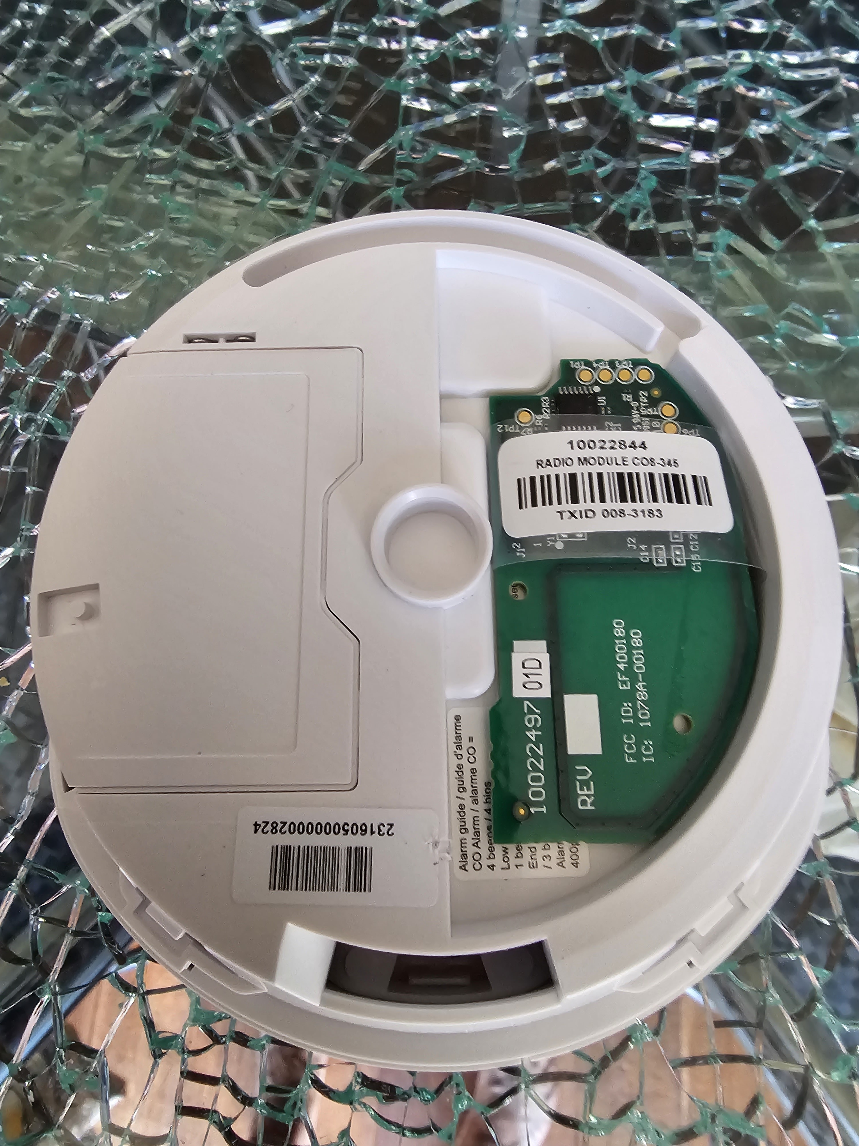

Please post a photo of the sensor label in reply I can help identify.
Box says CO8.
Will do, on the road.
If it is the CO8, not the CO8e, then you can learn it in via tampering it while the panel is in auto-learn mode, or you can manually add the TXID printed on the device when adding new sensor.

Can you clarify what you mean by prefix id#? That is not a programming field. Are you referring to the TXID?
Yes,
Br john
The TXID is unique to the individual sensor and is what informs the panel which signal to listen for.
