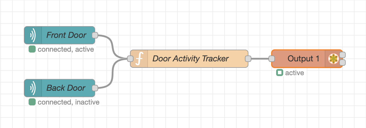

Currently, Alarm.com automations can only be triggered by a single event or sensor. However, IQ Mate can be used to combine multiple inputs and create complex triggers to activate Alarm.com automations using an Event-Triggered Rule.
In this tutorial, we’ll walk through how to use IQ Mate to create complex automation logic, such as triggering an output only when both the front and back doors are open. We’ll then show how to use that output to trigger an Alarm.com automation.

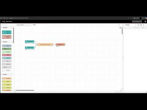

Step-by-Step Video Guide
In the video, we cover:
  • Setting up MQTT sensor monitoring using the Qolsys Sensor subflow
  • Creating a function to track multiple sensor states
  • Triggering an Alarm.com automation only when both sensors are active
