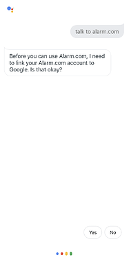

To set up Alarm.com on Google Home using your voice and Google Assistant:
Note: The device must have the microphone and Siri enabled for the Google Assistant app in the device’s settings to give Google Assistant voice commands.
  1. Open Google Assistant and say, “Ok Google” or “Hey Google” or tap the microphone at the bottom of the screen.
  2. Once the microphone has turned into colorful dots say either: “Talk to Alarm.com” or “Speak to Alarm.com”.
  3. If an account is not yet linked, Google Assistant says: “Before you can use Alarm.com, I need to link your Alarm.com account to Google. Is that ok?”
  1. Tap Yes.
  2. Enter the user’s Alarm.com account credentials.
  3. Tap Allow.
Note : If the Google Assistant returns a Google search for Alarm.com instead of the Link card, the device is not compatible with the voice process.

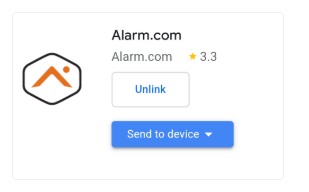

  11. Tap to expand Send to device.
  1. Tap to select which devices to enable voice control for.

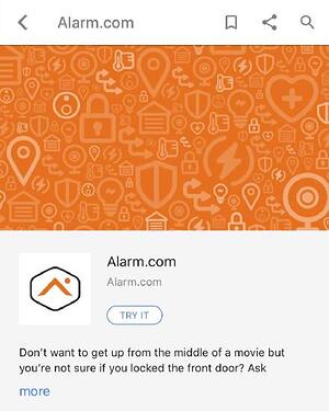

To set up Alarm.com on Google Home using Google Assistant on iOS:

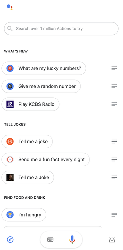

  1. Open the Google Assistant app on the mobile device.
  2. Verify the customer is logged into their Google account for the Google Assistant app.

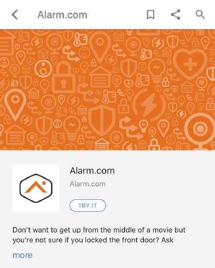

  3. Tap Compass Icon
  4. Enter Alarm.com in the search field, and then tap Alarm.com in the search results.
  5. Tap Link
  6. Using the Alarm.com username and password, log into Alarm.com and link the account to the user’s Google Home.
  7. Tap Allow.
  8. The Alarm.com account is now synced with the Google Home account. Tap Try It to test commands using the Google Assistant app.

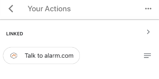

To disable the Alarm.com account on Google Home, unlink the Alarm.com skill.
To unlink Alarm.com from Google Home:

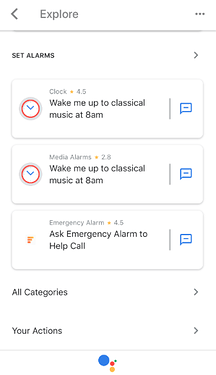

  1. Open Google Assistant on the mobile device.
  2. Tap Explore Icon (Compass). This icon may look different depending on the device used.

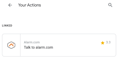

  3. Flick to the bottom of the Explore page, then tap Your Actions.

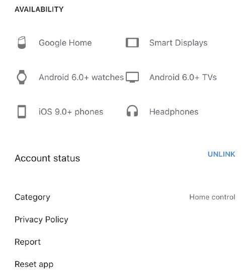

  4. In Linked , perform either of the following
  5. Perform either of the following to disable Alarm.com from Google Home:
