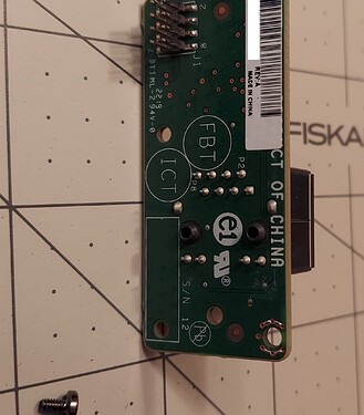

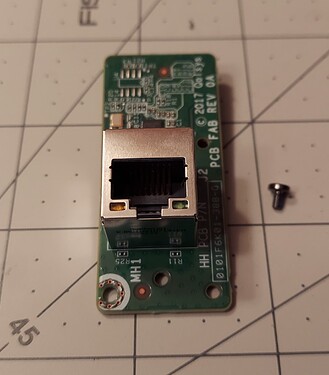

  1. Unbox the IQ Card Ethernet. You should have the card and one set screw.

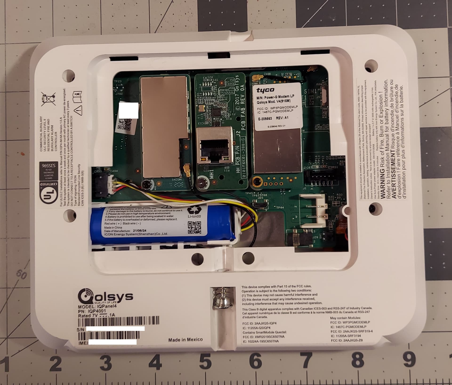

  2. Install the card, pins first. Ensure they all connect and are seated properly before securing with the set screw.
  3. Installed card should look like this:
