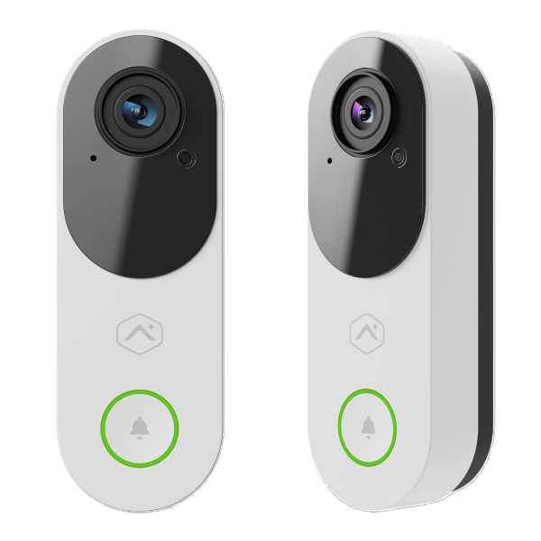

How to Configure a Video Analytics rule for the ADC-VDB775
ADC-VDB775’s Video Analytics means less noise and more relevant recordings. Select the event types you are interested in (e.g., person, vehicle, animal) and the ADC-VDB775 will not record when Other event types occur.
