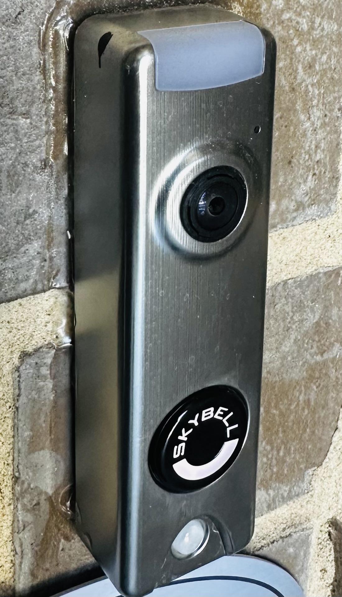

What is the model number of the skybell you have? This can be found on the back of the unit itself. A picture of the doorbell may help to identify as well.
This one. I don’t see a model number anywhere.
On Skybell app it says: SB_TRIM2_0001
That is the Skybell Trim 2 doorbell. Unfortunately that one is not compatible, I believe it is only made for Total Connect service.

I can use that with SkyBell app and it works great there.
So I guess there’s no workaround to use this doorbell?
No, that doorbell model was designed for Total Connect, it is not Alarm.com compatible. I believe any Skybell model can be used with the Skybell app.
