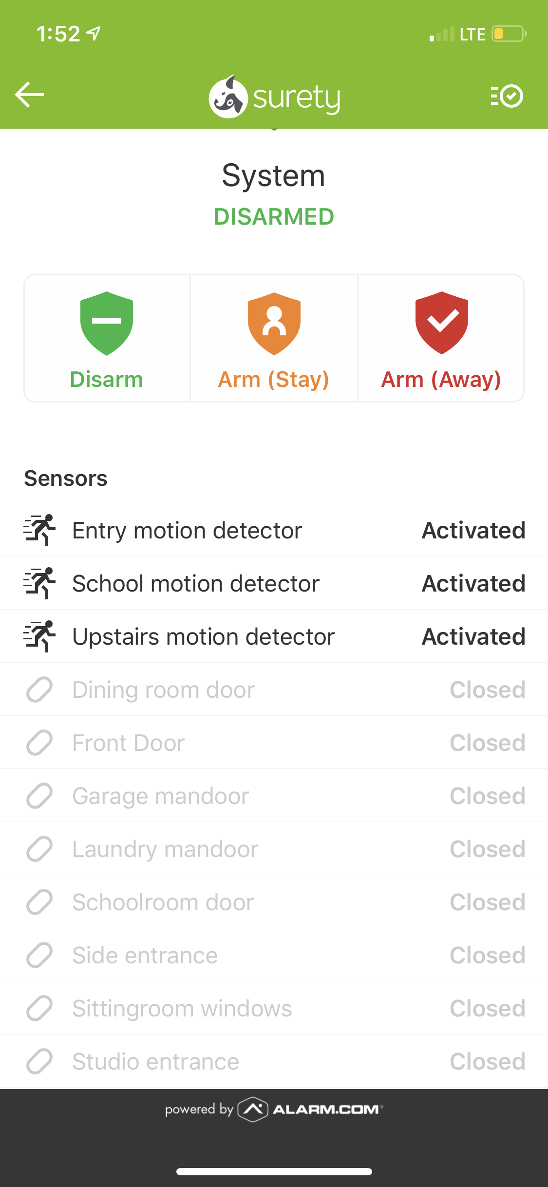

Also not sure if this is normal…or perhaps an insight to the problem. My motion detector often show “activated” even when nobody is in the house. See attached photo…
I took this screenshot about 10-15 minutes after I left the house.
That activated status is normal and do not necessarily indicate anything strange here. The Activated status in Alarm.com lasts for about an hour. Actual current status for a motion detector is useless as it only opens momentarily then closes again, unlike a door or window which can be left open and remain in one of two states.
Alarm events from the sensor mean that it is being triggered at that moment.

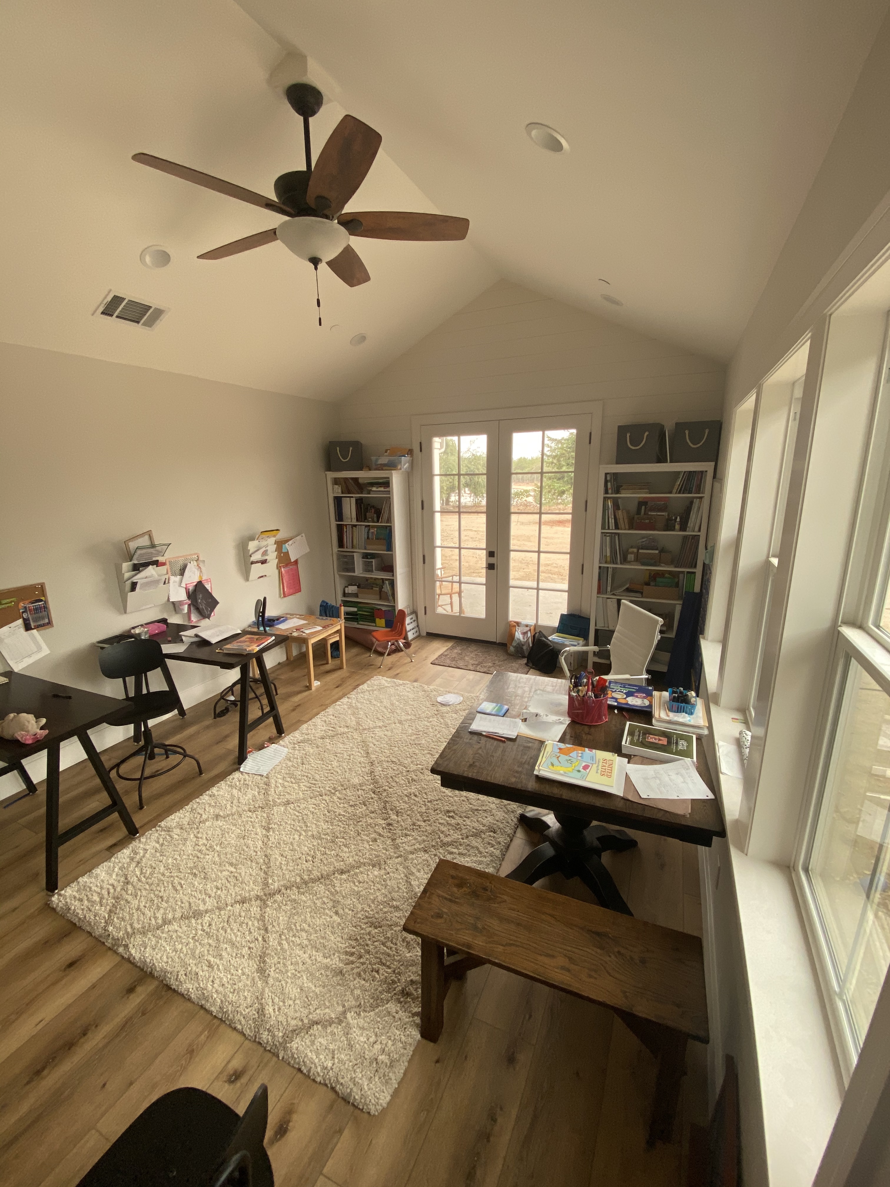

So the motion is about 7’ off the ground and there is a ceiling fan about 9-10’ off the ground? Here is a pic from the perspective of the motion. The french doors are in direct line of sight. No close by vents, but they are there…
The door is about 19’ away…
Hmm, is the fan on when you notice the false alarms? Is it strong enough to knock papers to the floor off the wall or desk? I’m not confident it would be sensitive enough to capture that, but in the absence of other explanations, that looks like a possibility given the room.
I could have been on but it only runs on low, so it moves just fast enough to circulate air. Doesn’t agitate papers and such. I will test later today.
