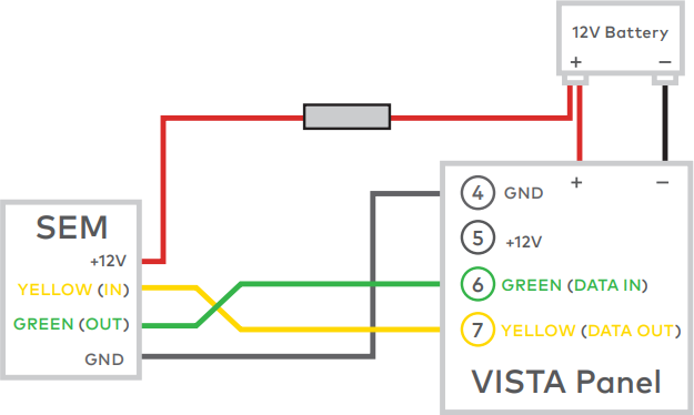

Wire the SEM to the panel
Alarm.com states that • Four-conductor, 22-gauge or larger stranded wire is needed.
Caution : Verify panel AC power is removed and the backup battery is disconnected when wiring the SEM.
  • Connect panel terminal 4 (GND) to SEM GND.
  • Connect panel terminal 6 (GREEN: DATA IN FROM KEYPAD) to GREEN (OUT).
  • Connect panel terminal 7 (YELLOW: KEYPAD DATA OUT) to YELLOW (IN).
  • Use the included red cable with the two prong battery connector to connect the battery to both the SEM and the panel. For a power limited circuit, ensure the fuse is inside the Vista panel.

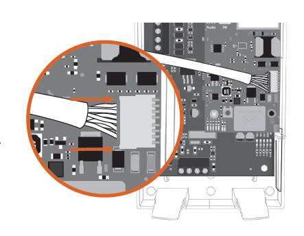

Once wiring is complete, route the antennas outside of the enclosure, away from the SEM, and replace the enclosure cover.
Note : The antennas should be routed through the second and third channel openings at the top of the enclosure as shown in the following images:
