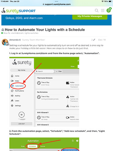

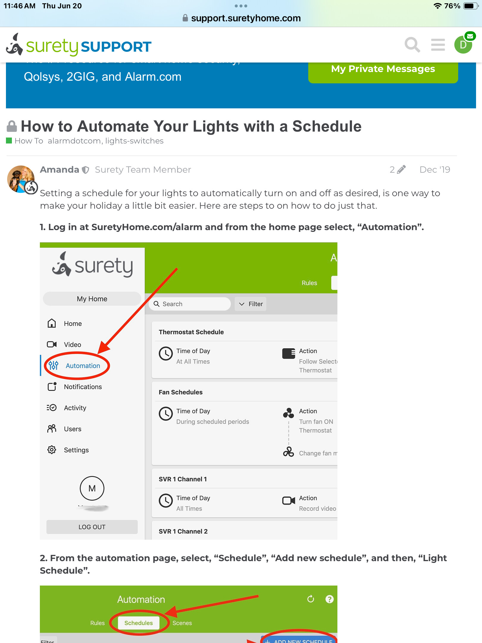

Perfect, thank you.
Found in your reference link where you actually can set schedules.
This is what I was looking for! Thanks
