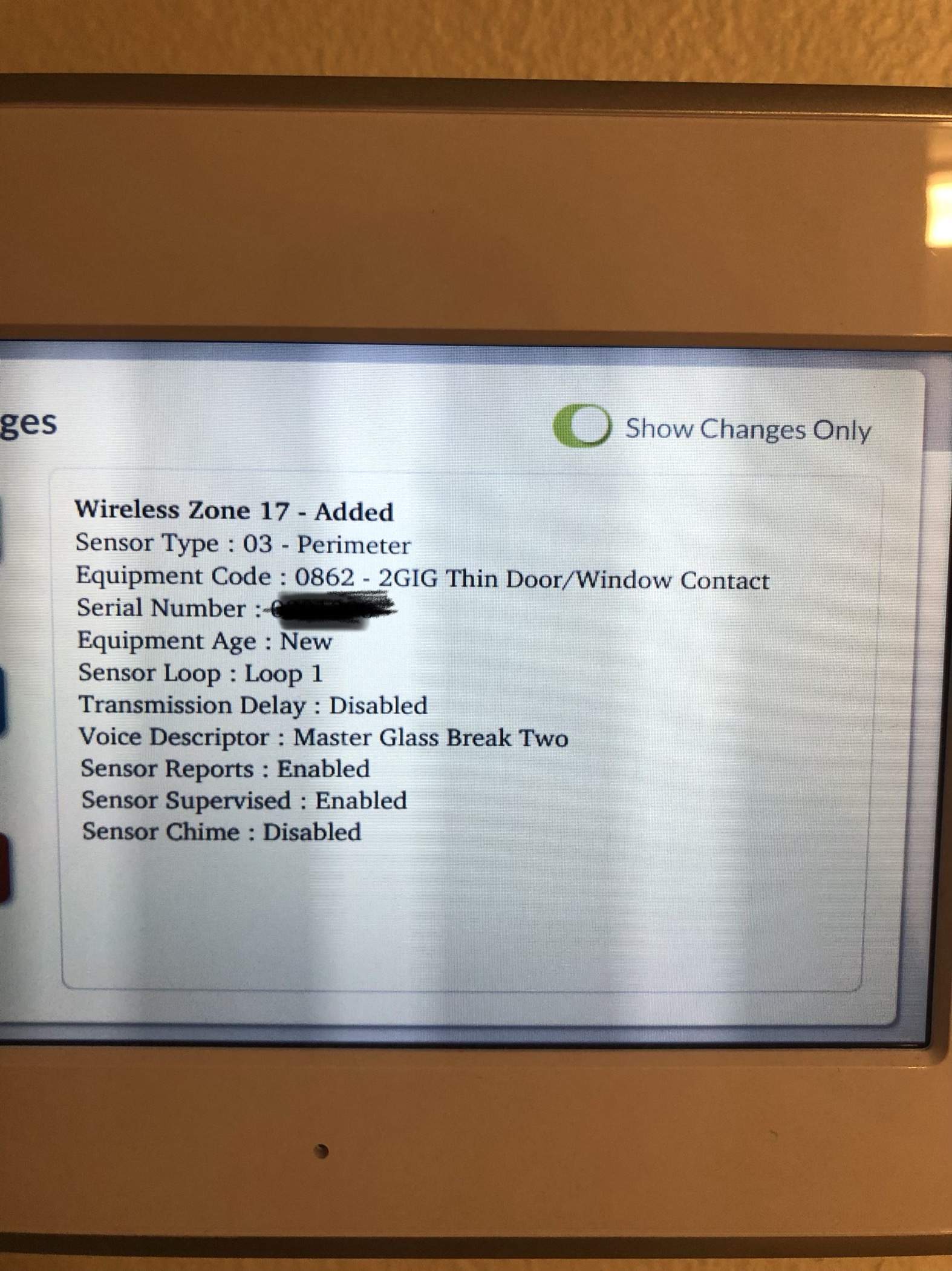

Yes, it seemed to learn fine. See attached pic. As far as trying to trip it, I gave it a couple of good whacks with the handle of a screw driver on a table top.
It can take a few tries to get the right vibration to learn in. These are new piezos correct? (not associated with the GC2 above)
And the piezo is wired correctly into the DW10? Have you tried swapping the piezo you know works into the other DW10? This would rule out an issue with the DW10 Aux terminal to help isolate the issue.
No, polarity does not matter connecting them to the DW10.
By chance are you using the Sensors Test feature on the GC3? As an aside we have noticed severe inconsistency with the Sensors Test feature in the past on the GC3 panel.
The best way to test sensors is to test under normal alarm conditions. Place your account on test mode with the central station if you have 24/7 monitoring, and then arm your system.
Trip the sensors by tapping with the screwdriver handle on the pane. If the sensors learned in via activation this way and are programmed as Loop 1, you should have no problem activating them.
