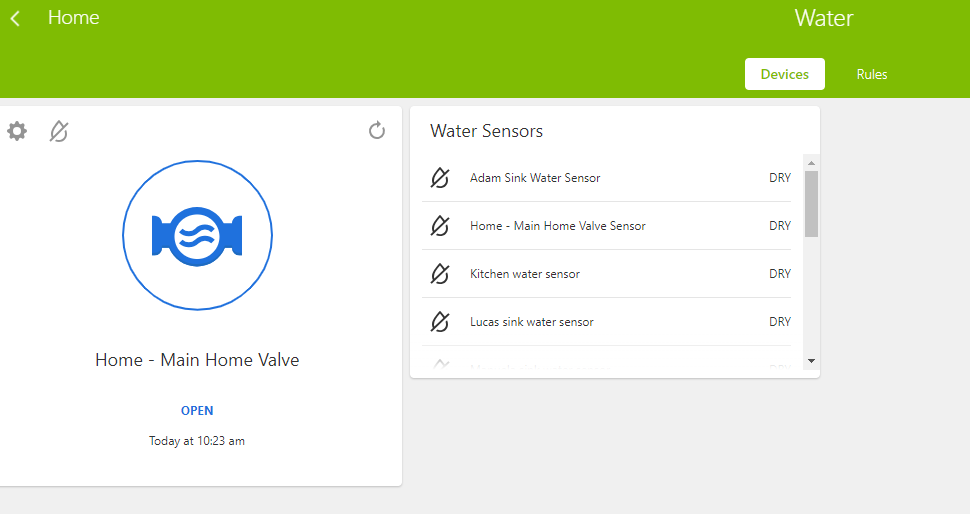

I do not have that option anywhere in water tab or in notifications. please see screen shot bellow.

and if I go to notifications Moen main home valve is nowhere to be selected.
Do not select the Alarm option (the one in your screenshot.)
Select the Water > Water Sensor Alert notification. The top one, not the bottom one.
Your main house valve is at the bottom of the list.

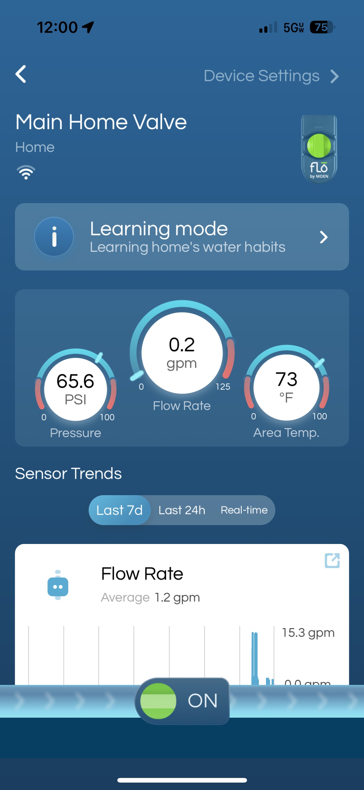

Are you able to view water usage data in the Moen app?
Ok I found it, Sorry did not see it. Very limited notifications only when its actually actuates. No notification for water leak or any other “water Valve” related important notifications.

I’m sure there is. I know from my buddy that everything that is seen in moen app is shared with Ring security in there integration. I also did some research and it looks like is shared in Google eco system as well.
Yes app has tons of awesome information. please see bellow.
So if alarm.com is paying for API cost then we got the cheap end of the stick as others are getting all available data. Maybe is because they have there own valve, IDK? but if they advertise that it should have all this data then, it should. I think if others get all data then alarm.com should as well not just on/off functions.
