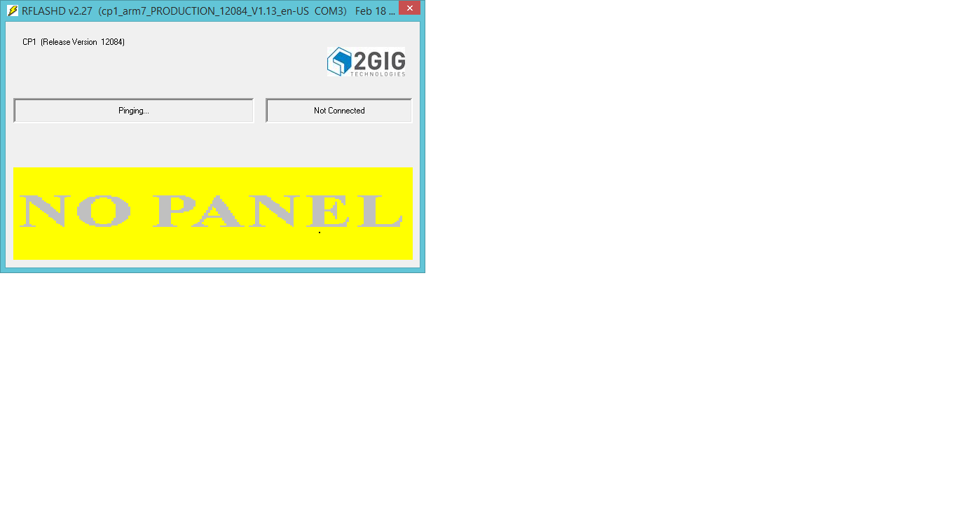

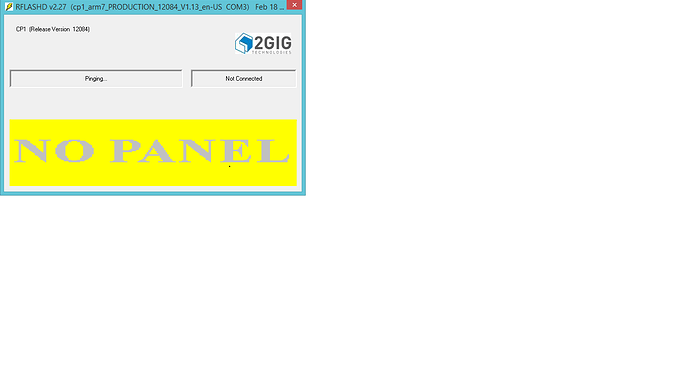

I am trying to do the update but can’t get past this screen. I don’t know what to try. Prior to doing the update I swapped out the 345MHz with a 900MHz. Current version is the 1.12. I am trying the 1.13 first and I have not received a fail, the screen just doesn’t change.
I ran a troubleshoot on my USB port and it says that the cord isn’t compatible with the 3.0 ports on the computer. I have to plug it into a 2.0 port, could this really be the issue? I can bring home a laptop from work if I need a 2.0 port.

The software will only recognize the panel once it is plugged in while the cable is connected.
So, just to be sure:
Power down panel, plug in USB, plug in four pin, open software, plug in panel power. Did you do the steps in this order?
Yes, I just had a chance to do it again and same result, nothing.
If the pc isn’t recognizing the update cable, then try a different pc. My understanding of USB 3.0 is that it is backwards compatible with 2.0. The 3.0 receptacle is bigger and will accept 3.0 and 2.0, but a 2.0 will not accept a 3.0. You may just need to install the proper drivers.
If after you install the cable, you see the COM port for it in device manager, then it sees it properly and recognizes it, and it is compatible.
If you have windows 10, see: https://suretyhome.com/forums/topic/win10-firmware-update-how-to/
My suggestion is that you watch the posted video again, and follow it step by step. Verify cable J4 end is properly connected to 4 pins between transceiver and cell module (lift the transceiver out of the way so you dont damage antenna). It only fits one way.
USB 3.0 and USB 2.0 (or earlier) Type-A plugs and receptacles are designed to interoperate.
USB 3.0 Type-B receptacles, such as those found on peripheral devices, are larger than in USB 2.0 (or earlier versions), and accept both the larger USB 3.0 Type-B plug and the smaller USB 2.0 (or earlier) Type-B plug. USB 3.0 Type B plugs are larger than USB 2.0 (or earlier) Type-B plugs; therefore, USB 3.0 Type-B plugs cannot be inserted into USB 2.0 (or earlier) Type-B receptacles.
Micro USB 3.0 (Micro-B) plug and receptacle are intended primarily for small portable devices such as smartphones, digital cameras and GPS devices. The Micro USB 3.0 receptacle is backward compatible with the Micro USB 2.0 plug
Source: USB 3.0 - Wikipedia
Also, another option is to have the firmware pushed OTA to panel via cell module or bridge.
