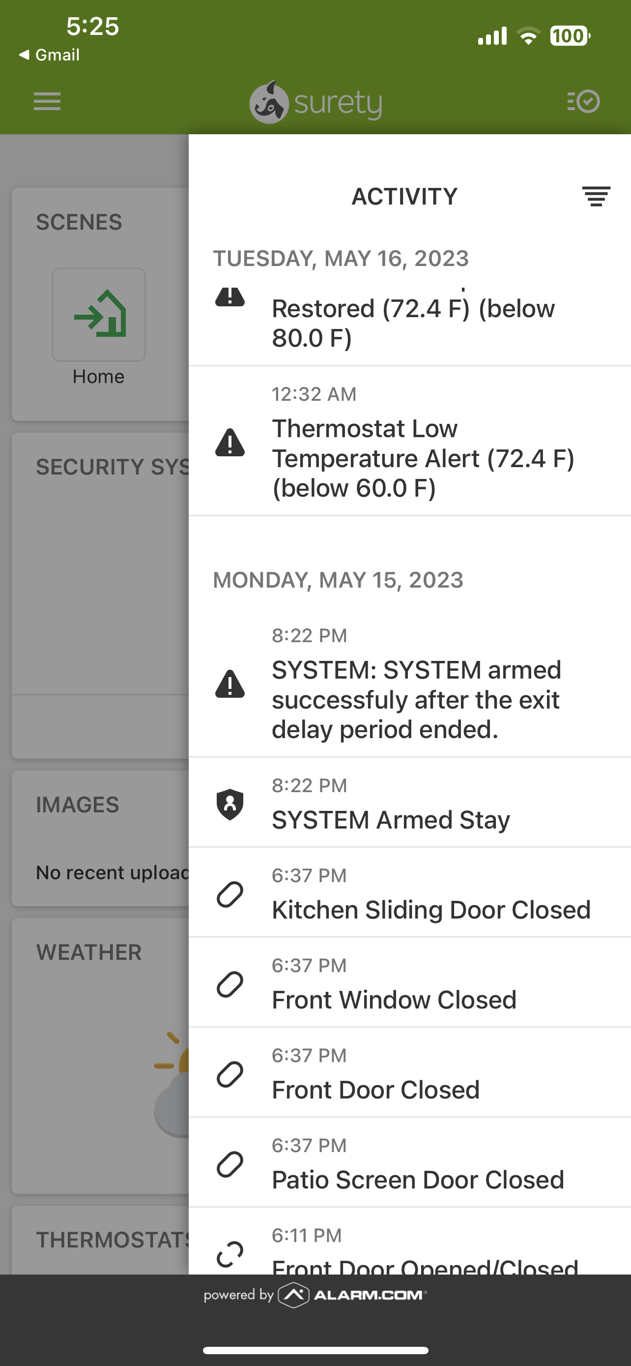

Just setup ADC-T3000 thermostat with my IQ panel 4. Only problem I’m having is with the temperature alerts.
Initially (several days ago) I setup the system with alerts for under 60 or over 80, but within a few hours I got alerts when the temp was in this range which is obviously an error.
I then deleted the notification via my alarm.com account online, waited 5 minutes and recreated the notification but this time just with the over 80 alert. I also rebooted the panel.
Multiple days went by with no issues after having eliminated the lower temp from the notification.
Lastly I decided yesterday to try adding back in the under 60 portion of the alert. Within a few hours I got the same type of error as when I initially tried setting up the system with 2 temp constraints in one notification.
Screen shot from last night is attached.
It would seem that I do not have errors with just a single temp notification but do have errors when there are 2 temps for the panel to consider in a single notification.
Is there a way to create 2 separate temp notifications, one for under 60 and one for over 80? It seems this is possible with humidity notifications but not with temp notifications?
