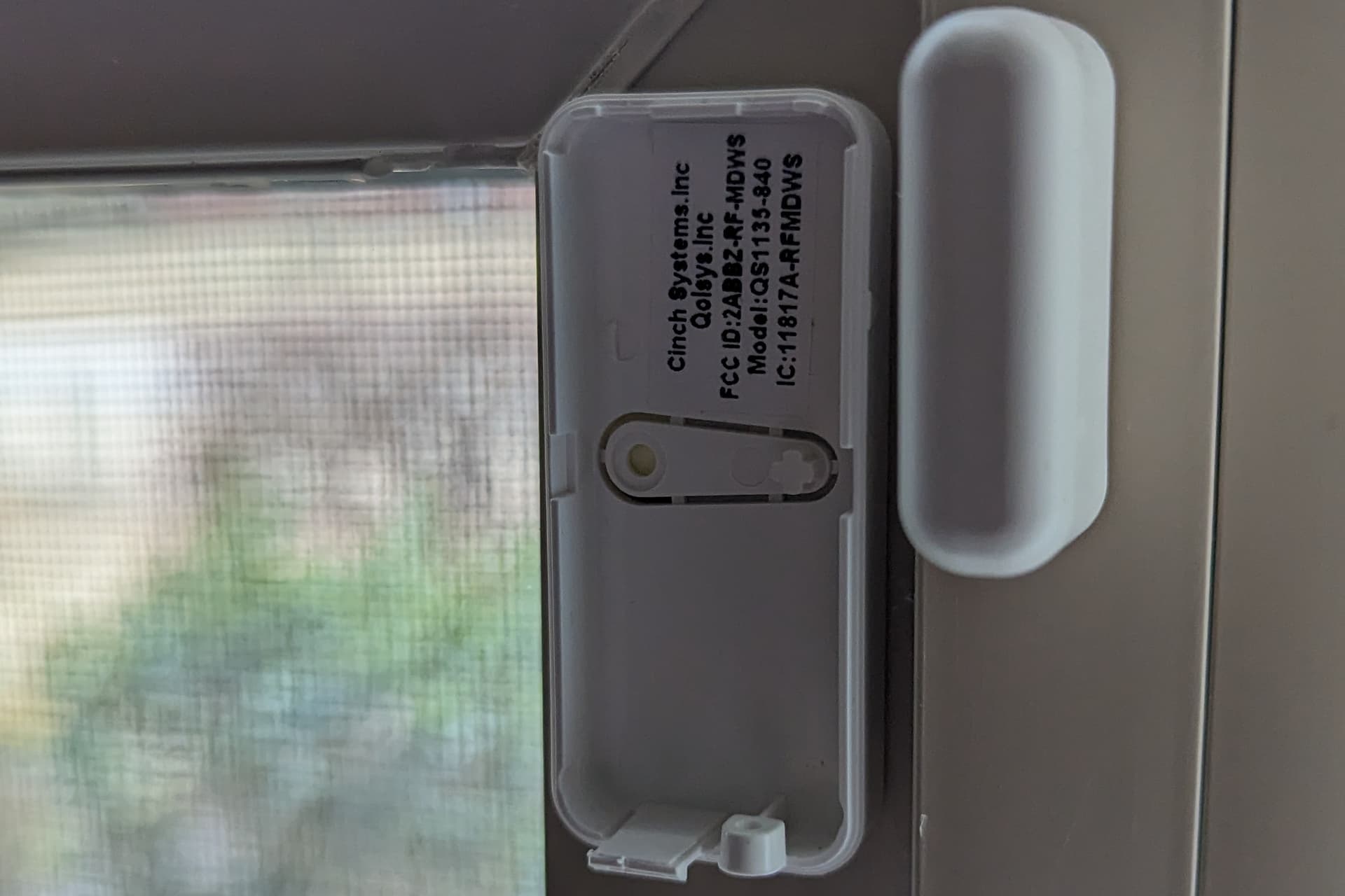

Could you open up the one that tampered and show a photo of the back plate where it is attached to the wall?

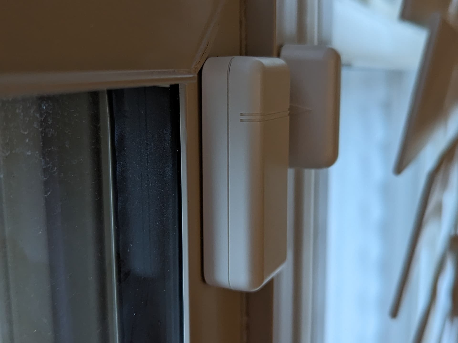

Thanks, I wanted to be sure the rear tamper break-away was intact. When you close that sensor, can you provide a photo of the sensor from the side, roughly?
Is it firmly sealed or does it have some wiggle room when closed?
Interesting. I get tampers here and there, and sometimes during armed state…but never causes an alarm? Maybe mine is broken.
By the way, I can’t tell from the photo, but the bigger part of the sensor should be placed on the part of the door/window that does not move (to avoid excess vibration, which may cause tampers or tamper prone states), and I would align it more centered. I find that helps (or solves the tamper for the door/window contacts). But, then again, I sometimes get tampers from sensors that don’t move like water and motion sensors.
It is firmly sealed when closed.
I wish mine were like yours and a tamper didn’t cause an alarm. What panel do you have? I searched for an option to disable tamper induced alarms in the panel setting and never found anything. A couple years ago when I asked here I was told such a setting didn’t exist, at least not for my panel (IQ Panel 2). I sure wish they would add that as an option.
Tampers will result in alarms if the panel is armed at the time. Does the window have any play or vibration? It is generally better to put the sensor portion on the outer frame not the window. If you swap those, do you experience similar issues?
There is no play or vibration in the window. The house is relatively new and the windows are tight and rigid.
