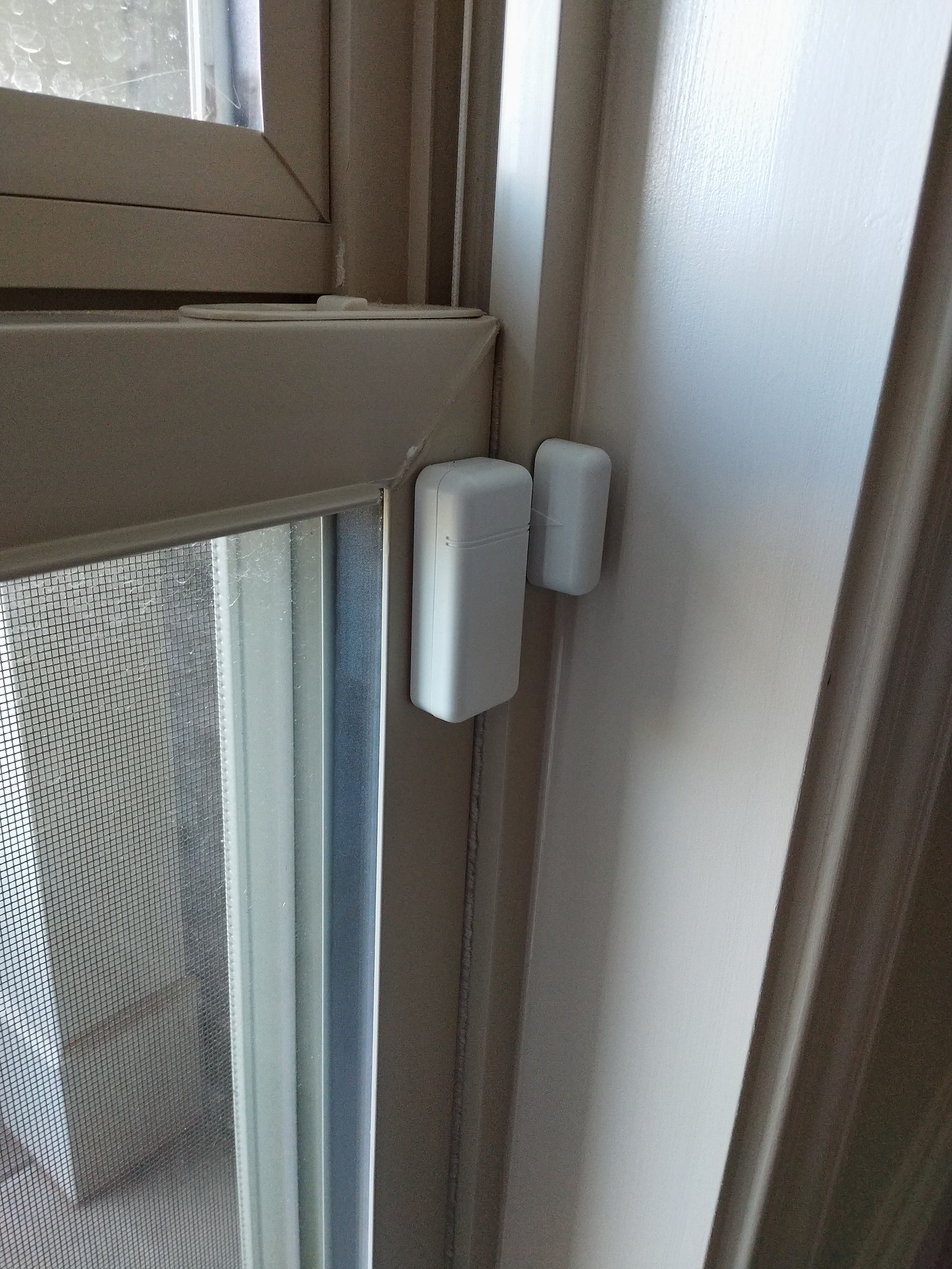

I got woke up this morning by a false alarm from a window sensor tamper. I have an IQ Panel 2 and the sensor is a Qolsys QS1135-840 IQ Mini-S. There was no evidence of a tamper, nor any weather that might contribute to a false tamper. Then this afternoon (with the panel disarmed), the same sensor sent several more tamper alerts.
The sensor is securely mounted on the window frame with the provided double-sided tape. The cover is secure. There isn’t anything in the vicinity to hit or knock the sensor. I’ve had this system for about two and a half years and never had any other problems with it.
Is this common? Is it more common after the sensors are a couple years old? Should I expect my other sensors of the same model are going to start doing the same thing? What typically causes this? Anything I can to do minimize the chance of this happening again?

The first thing I recommend is to open up the sensor and physically inspect the tamper switch. Is there anything visibly wrong? Is it loose?
If the tamper switch appears to be fine then I would check or replace the battery. A low battery should send a low battery signal, not a tamper, but I’ve heard of cases where a low battery did cause a tamper signal.
I just checked the batteries, both are at 3.03 V. They’re labeled as 3 V so I don’t think that’s contributing to the problem.
Is there not a “low battery” signal sent to the panel and corresponding message when sensor batteries need to be replaced? I’ve assumed that’s a thing, but I’ve never had a sensor with a low battery, so I don’t know. Sounds super inconvenient if the low battery notification is your alarm going off at 4am!
I took it apart and everything looks fine. The tamper switch depresses and springs back like it should, and the tab that depresses the tamper switch is in place where it should be. The sensor still sends open/close signals, and it sends a (not false) tamper signal when I open the sensor and an end of tamper when I put it back together.

Hmm, well I don’t see any issues at all with installation, and if you did not use the optional tear-away tamper screw mount inside there shouldn’t be a reason for a tamper.

I’ve reached out to Qolsys to see if they have any known issues with any production runs of that model of sensor, or any known firmware issues.
We’ve received one other report of an IQ DW Mini recently that sent tampers at odd times with no discernible cause. They were also using IQ Panel 2+ firmware 2.4.2. I think it would be good to be sure to upgrade to the latest available version.
There is no known issue like this according to Qolsys. If you notice repeated tamper alerts from a single DW Mini, Qolsys believes it would likely be a damaged or defective sensor.
I would try firmware first, but replacing the sensor would be the next step it sounds like.
