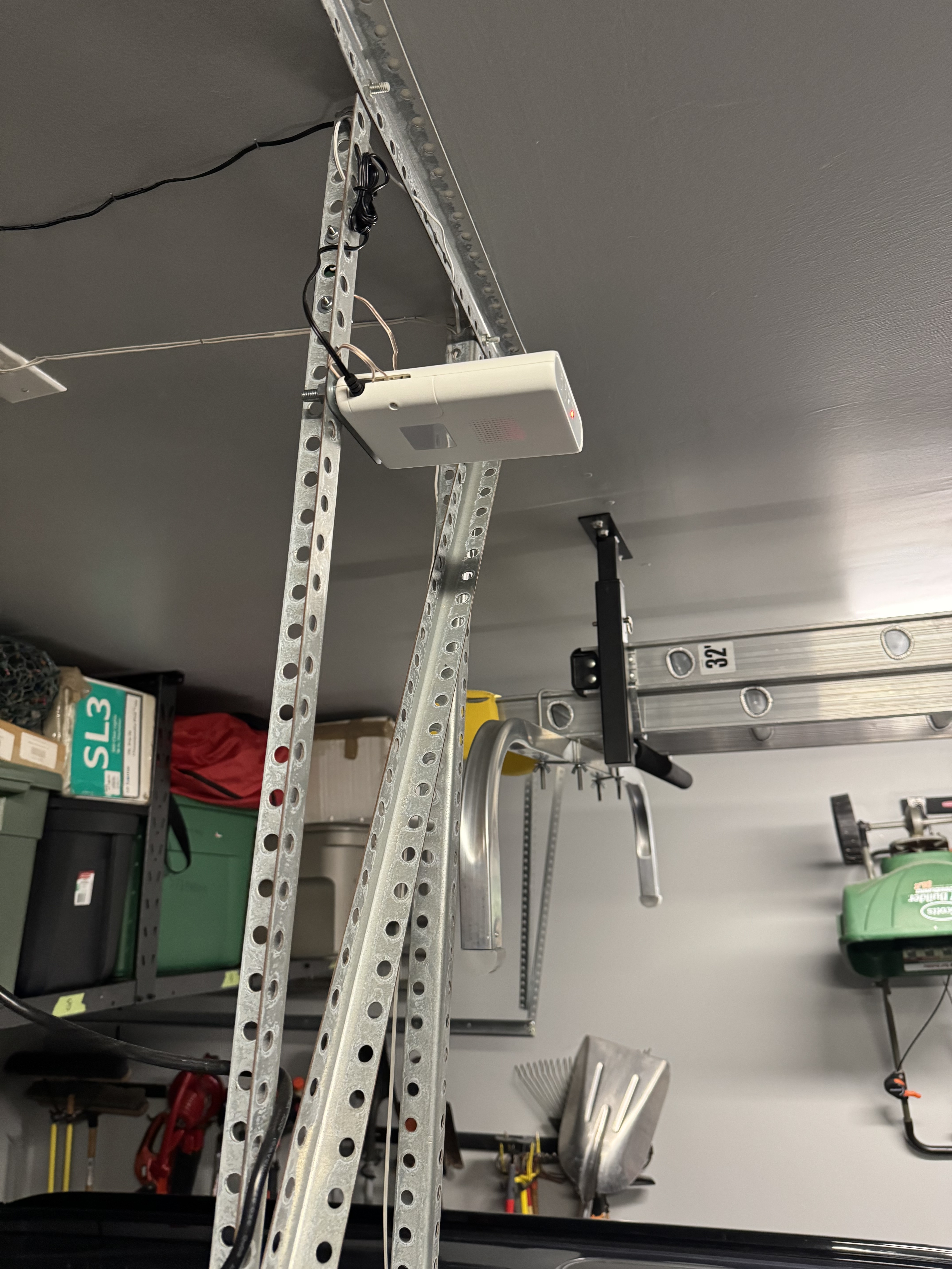

I’m running into difficulties installing my Ecolink garage door controller. The device I believe completes the Zwave inclusion as it beeps and glows green for about 3 seconds. The device immediately the glows red. I can see the device in the ADC app but it appears offline? I can’t also control my garage door wirelessly but I’m unsure if that is because of the potential Zwave issues. I know if I cannot control It wirelessly to use the garadget but not sure if my issues is the potential Zwave network problems.
I have resolved the red light & offline issue you have to sync the tilt sensor once installed which is not in the instruction manual. So I have it reporting in ADC now but can’t control it wirelessly looks like I will have to go with a garadget.

After some more use this weekend the Ecolink is showing some odd behavior. The Garadget works fine as I can push the contact button and the door opens, but the Ecolink seems to be loosing sync with the tilt sensor and glowing red. I have to manually open the door to resync the tilt sensor then hold the tilt sensor button to reactivate the relay. Spoke with Ecolink and did some trouble shooting the antennas for the device are located on the long edges of the device. When you install the suggested orientation should be as in my pic here:
Will run this configuration for a bit and see if communication improves with the tilt sensor. Hat off to Dave at Ecolink for his help trouble shooting this with me and they have offered to send a replacement device to me if it continues to have trouble. Very good support from the product developers on this one.
