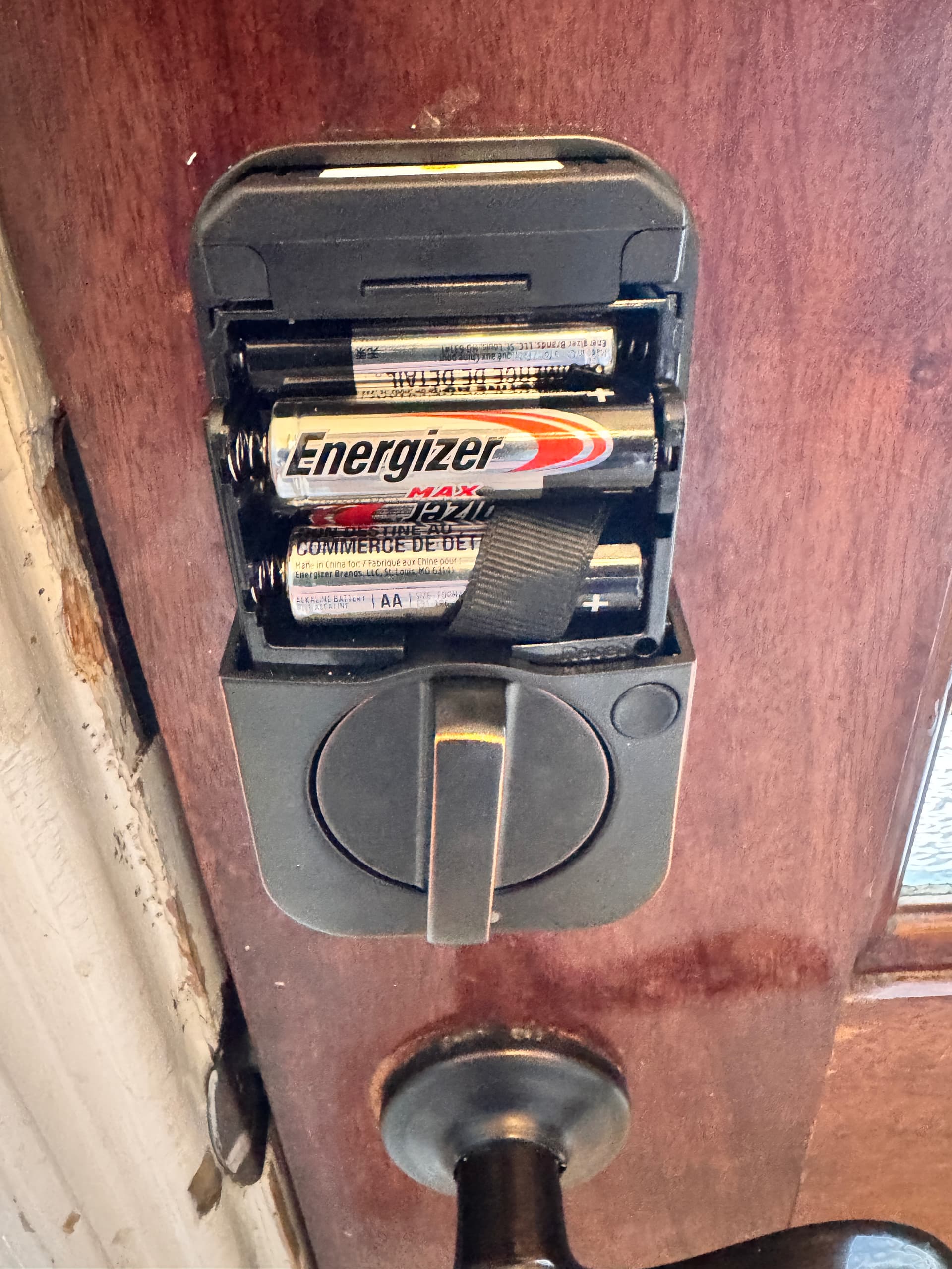

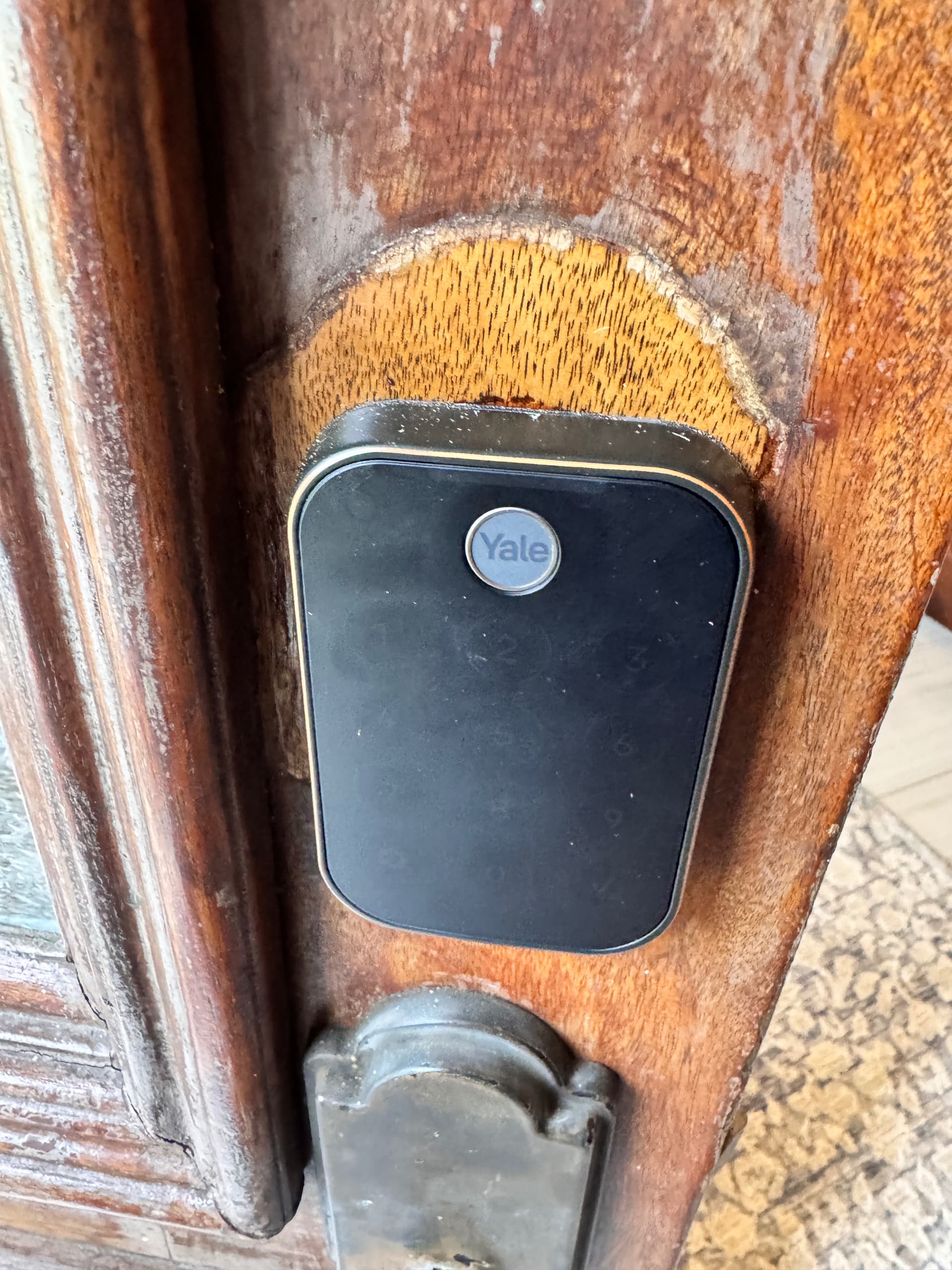

Can you send a picture of your specific lock, and the box it came in, including any specs that might be on the box?
https://www.amazon.com/dp/B0D971D8SY?ref_=ppx_hzod_title_dt_b_fed_asin_title_1_0
Here is a picture. You guys have both given me contradictory advise. Jason said use Alarm.com and you are saying don’t. My lock says its Z-Wave and Wifi
There is a sticker on top of the battery cartridge with information on it such as model number, etc… Can you share a pic of that sticker so we can read it?
