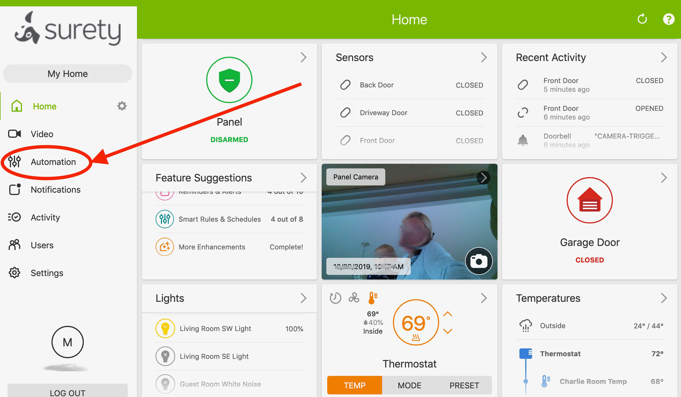

No Entry Delay is an option at the time of arming and can be applied either when arming via the panel or via the app.
Additionally you can create a scene in Alarm.com which arms the system with no entry delay selected, so that whenever you use that scene to arm the panel it will have entry delay disabled.
