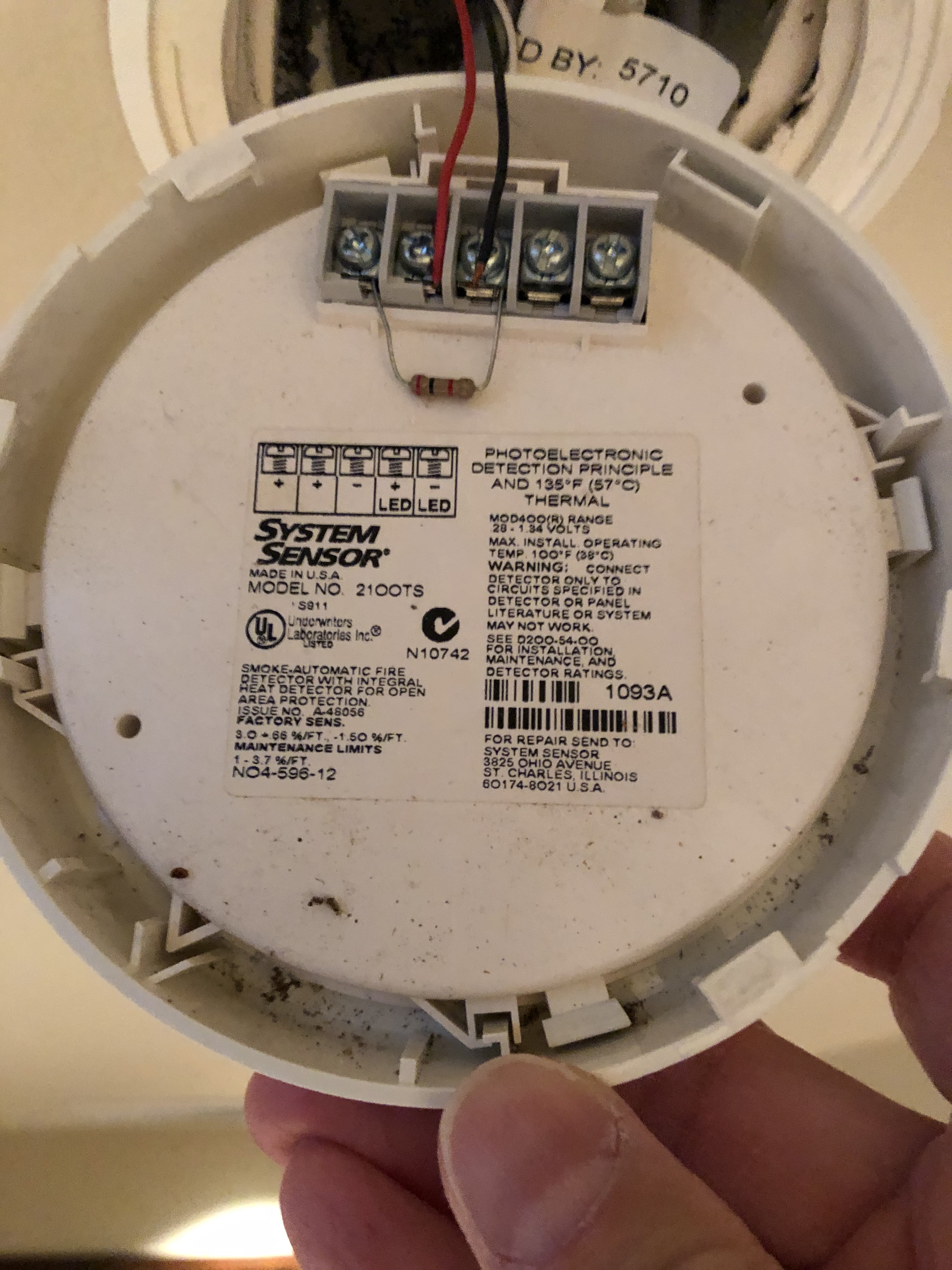

it turns out i was mistaken - there actually are two wired smoke alarms in the system, as in the photos below. the red and black wires appear to correspond to the red and black wires in zone 1 of the FA148.

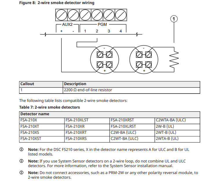

how do i transfer those wires to the PG9WLSHW8? is a resistor required? why is there a resistor at one of the alarms, and should it be there? how are these smoke alarms powered?
That’s a resistor correctly placed at the end of the line for a normally open zone type like the Smoke detector, yes it should be there. Two wire smoke detectors are powered across the two wires.
First thing is first though, check the installed or replaced by date. Those are likely past the replace by date. Smoke detectors have a hard end of life because the sensing element breaks down.
Actually I meant to mention there is no expiration date on either of these. To be safe I will probably just replace. Do you have a recommendation for a replacement model? Would they be wired in the same way? And then wired into one of the zones of the power g translator?
Yep, check page 18 and 19 in the manual of the wired translator for wiring instructions and a list of compatible models. Do not mix and match models. Use two of the same model and you should be good.
No, I don’t have a specific recommendation among the detectors, just be sure to use two of the same model.
First enroll the PowerG HW translator into the panel (Advanced settings - Installation - devices - security devices - auto enroll) by pressing the tamper button and programming all zones.
To enable the PGM2 output, go into Advanced settings - Installation - Devices - Security Devices - Add Sensor, Manually enter the PowerG HW Translators DL code and it will enable the PGM2 output for the 2 wire smoke detectors.
