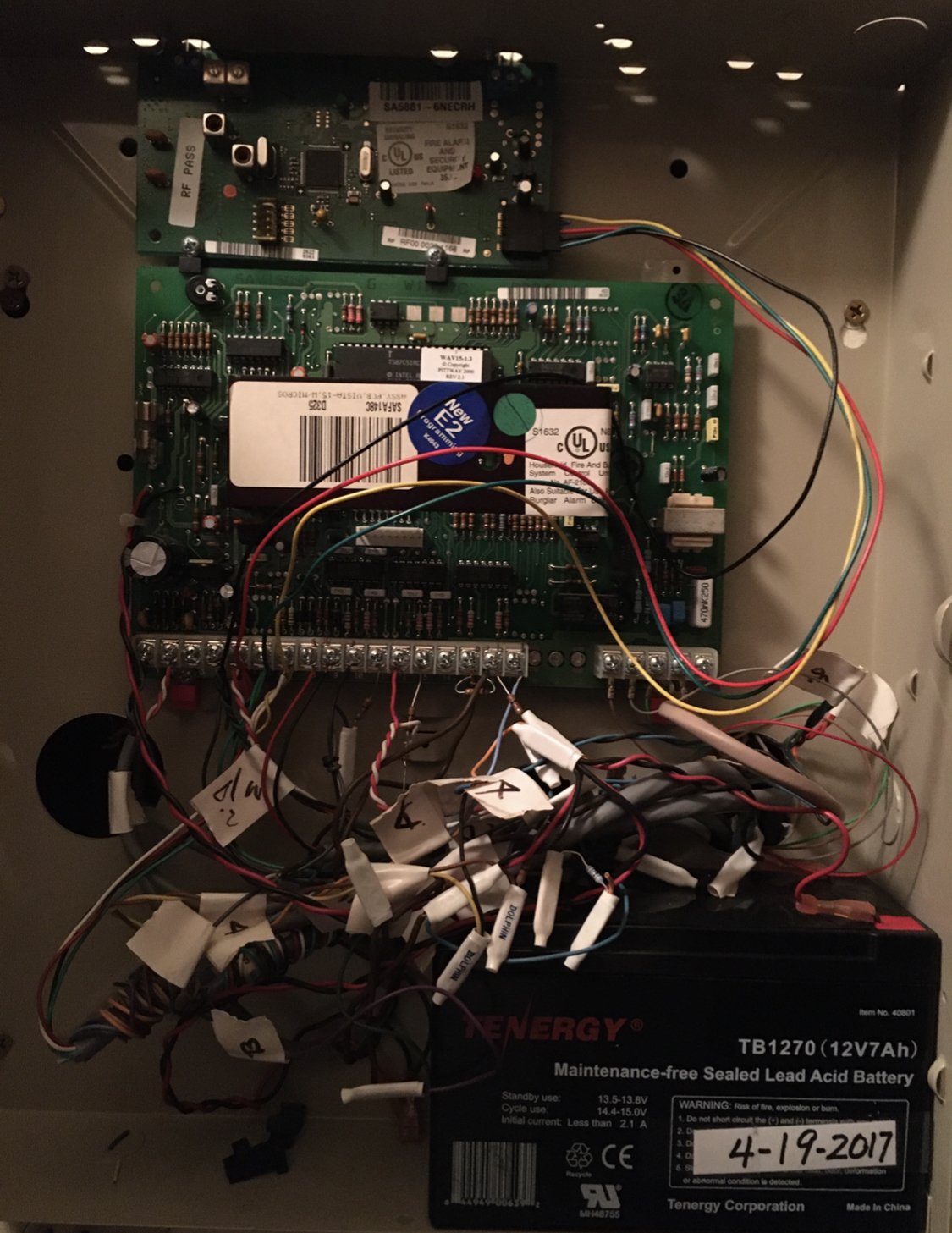

What the name of ur system if ur not sure u can post a pic of it

Unfortunately the photo is a little blurry and I am having a hard time reading the sticker that tells us the year and revision of that panel.
It looks like you have a First Alert 148 which may be useable as is with an Alarm.com SEM, but only on Revision 3.1 and higher on panels dated 2005 and newer.
Can you confirm the revision and date on the center sticker? Right above the “New E2” one in the image.

Seems like my panel is older than what you said would be required? What do you suggest?
Based on the image, your panel cannot be taken over by the Alarm.com System Enhancement Module described above. As such, replacement of the panel would be necessary.

In this case your panel or system as shown in the picture above, is too old to use the System Enhancement Module (or SEM).
In order to use service with Surety, a new Alarm.com compatible panel with a 4G LTE cellular module would be necessary.

The Qolsys Hardwire 16 would be mounted in the same place as your system in the picture above. This manual gives a rundown of what to expect when connecting the Hardwire 16.
The old equipment board could still be utilized as a charging circuit for the backup battery to be used with the Hardwire 16.

Wireless sensors cannot be enrolled into the Hardwire 16, the HW16 is only for converting wired sensors to wireless.
The IQ Panel 2+ sold through Surety uses 319.5Mhz as the wireless communication protocol. It looks like the wireless sensors enrolled into your current system use the Honeywell 345MHz protocol which means that they could not be learned directly into the Qolsys panel.

The IQ Panel 2+ does not utilize landline. As such, the landline connection is not needed and could be removed form the current system if desired. It would have no bearing on the connection of the Qolsys panel however. It looks like Zones 21-24 on the old board are for the phone line.
