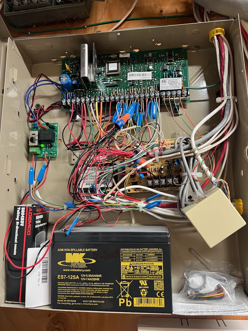

I just bought a property with a wired system.
I am not on-site right now, but I’ll attach a photo I have of the existing system. It looks like the chip is labelled WA20P-x.12 HONEYWELL 201x REV x.x
Resolution isn’t awesome, so I’m guessing a little and can’t tell on the "x"s.
There is at least one keypad, and I understand that the system has a cellular module, but I don’t know where that is located.
What would I need to purchase to get this into the Surety ecosystem?
Honeywell Vista 20P requires an Alarm.com System Enhancement Module (SEM) in order to connect to Alarm.com. The SEM is the 4G LTE cellular module and Z-Wave radio.
We do not carry it but the SEM300 is the most recent version of this device.
More information on pairing this device, including which models are compatible with Alarm.com, can be found below:
Otherwise, you can replace the system with a Qolsys IQ Pro, or an IQ Panel 4 and a Hardwire to Wireless Translator.

I have decided to go with the easiest (and cheapest) solution for now as I learn more about the various systems at this property. I bought an ADC-SEM-300 and I am heading up to the property tomorrow.
I’m following these directions: How to Install a SEM 300 System Enhancement Module for Honeywell Vista
Questions:
  • Just confirming that I should be able to reset the Vista installer code without anything from previous owner / previous alarm company
  • When should I setup / activate new alarm.com account?
  • Other than the items / materials listed in the linked thread above, anything else I should be prepared to do to get the SEM300 installed, activated and the existing Vista system connected to ADC?

After a false start with a previously installed SEM300 (and never removed) I finally got this working with a new old stock SEM300.
Now I just need to start to figure out the system!
Let me preface with: I would welcome a simple point to the right resource(s). I did some Surety DIY forum searching last night, but didn’t find what I was looking for.
I have fixed some issues but still have questions. For future forum searches, I’ll keep my updates / answers below.
Update: I suspect in my diligence to remove the former cellular module I also removed the RF receiver - thus the “Check 100 RF Receiver” error message and the loss of signal from water sensor, heat/smoke detectors and glass break sensors. Now I just need to figure out which module was cellular and which was RF sensor :wink:
Final update: this was, indeed, the issue. I re-installed the RF Receiver Module, power cycled the system and eventually did a double disarm at the panel - this solved the Check 100 RF Receiver message and eliminated the low battery message on a glass break sensor (after replacing the battery).

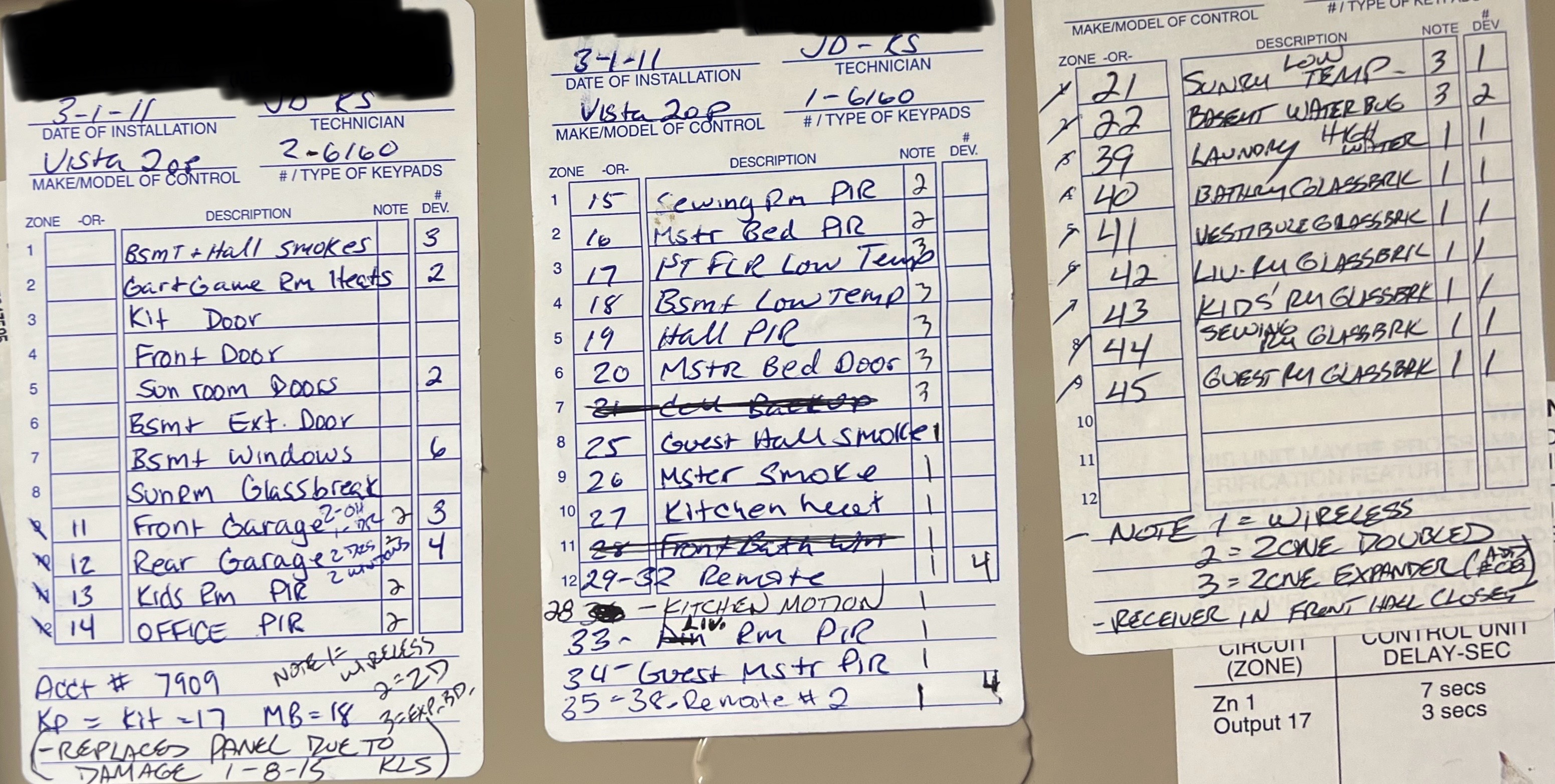

I am trying to reconcile hand-written notes on the physical Vista 20P panel along with sensor / zone names I see in the 6160 panel along with names that I see via ADC website / app.
On my physical panel I see most sensors labeled with a zone number, a name and some notes. The notes indicate whether the sensor is wireless, “zone doubled” or “zone expander”.
I have a few questions:
Why don’t the ADC names match what I see on 6160?
What is a “doubled-zone” and how does that work?
Is there an easy way to try to map the ADC sensors to the hand-written notes that I have? As far as I can tell, on ADC all I can see is the name of a sensor (which often does not match the 6160 name and definitely doesn’t match the hand-written notes). For example, ADC shows a “Laundry” sensor, but 6160 clearly indicates that as zone 39 Laundry High Water (which matches the hand-written note).
The panel supports two zones wired into zone terminals 2-8. The doubled zone corresponds to another zone then if doubled. If you use zone doubling on 2, the additional zone is 10. 3 is 11, 4 is 12, etc.
The two zones must use different specific resistances which allows the panel to know which opens. It only works with Normally closed zones.
The zone numbers should be the same, so assuming the notes are accurate you could manually rename sensors in Alarm.com under Settings > Manage Devices if any do not match the specificity. It won’t show in Alarm.com in your sensors list whether a zone is wired to an expander or zone doubled, etc. That can be determined by inspection of the wiring to be sure.

I don’t see zone numbers in ADC otherwise I would be happy to change them manually.
It is a bit unintuitive to get to the zone IDs. Alarm.com tried to organize the devices in a more natural way according to type on that first Manage Devices page but it leads to some confusion.
Head to Settings > Manage Devices, then click the menu ellipse button on the right of one of the sensors, click device settings. You’ll come to a page with a list of all the sensors where you can rename them and change their sensor activity monitoring status if needed. They will be listed in their zone number order.
I’ve sent that command to get the panel names. Allow about 5 minutes before checking.
