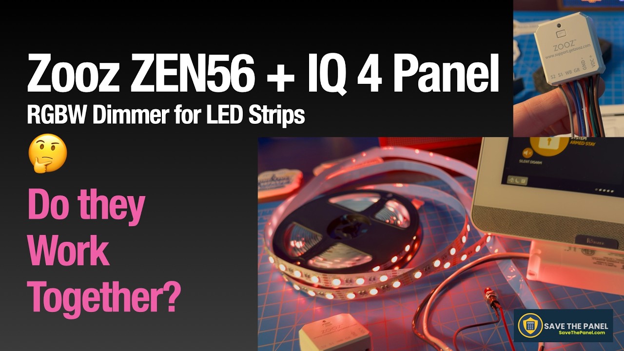

Funny you should ask. I just purchased one to test if/how it would work with an IQ 4 panel. My plan was to do a video on that for my Youtube channel. I should have that testing and video done in about a week or two, so I’ll post back here.
awesome, fingers crossed!
Apologies for the delay, but I finally tested the ZEN56 with the IQ 4 and ADC!
The good news is it works on IQ 4 and Alarm.com, but there are a couple of caveats depending on the light strip use, how the parameters are set, and where you plan to control it (the IQ panel itself, the ADC app/website, or with Automations, etc).
I tested it two ways: in the default single multicolor mode, and with Parameter 16 set to expose individual RGBW endpoints. Both include successfully, and Alarm.com does recognize it as a color device. There’s a washed-out color issue with the 5050 RGBW strip I was using in the default mode, but I found a simple workaround for that too.
Here’s a link to my video showing the bench testing:
I hope this helps! Please let me know if you have questions. I’ll keep this on the bench for a while in case you would like me to test something specific.
