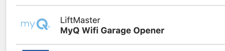

To clarify, there are 4 different MyQ device types to select from when adding a new garage door.
If you have MyQ overhead controllers with wifi built in, the following option is the one to select in the Add Device page in Alarm.com:
If you were selecting one of the other 3 Liftmaster options that would explain why some of the steps in Alarm.com seemed nonsensical and confusing. They are for other device types.
It would also explain the error message you described at one point stating that a Gateway serial was required. That would be steps for a different set of MyQ hardware.
Try one more time to register the devices. Select the icon in the image above when adding garage doors in the Alarm.com website.
