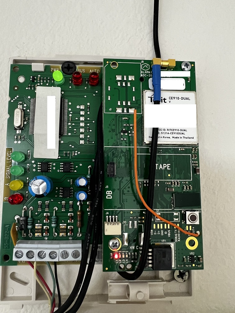

I have found some upgrade packages on ebay that say they’re meant for replacing existing CDMA/3g cellular communicators for my panel, however I’m not certain yet if they would work. My panel currently is hooked up to Verizon, these upgrade panels are for AT&T, does this matter? Also it states that I would also need to have a Concord Panel version 4.0+, and a SuperBus 2000 gateway module. How do I ensure my panel is version 4.0 or greater, and is the SuperBus 2000 gateway module the circuit board with lights that the current 3g board seems to be ontop/connected to?
EDIT: The page listed needing a SuperBus 2000 Gateway (60-861), the board I’m referring to that the cellular module connects up to doesn’t look exactly the same circuit wise (but is enclosed in the same housing on pictures I see online). My board says 55-822-A, looks like I’d need to purchase this as well?

I installed the new unit, set up my surety account and have access to alarm.com again. I’m able to see all my sensors on alarm.com, however I see a bus 1 error on the concord 4 keypad. From researching it looks like I may have to remove my old 2g panel from the accessories menu, however when I look at the list of IDs there, I can’t seem to match it with any of the numbers on the 2g superbus circuit board. I want to make sure this is it before removing, or maybe I have something else wrong if not.
Also with that said, do I have to manually add the new 4g accessory too? or does that auto add to the next available ID?
If you see BUS 1 error, that means the ID associated with BUS 1 needs deleted.
You can manually delete a bus device by entering the installer menu and going under System Configuration > Accessory Modules > Bus Device Settings

You do not need to add the new one manually, it is automatically set.
Is there any way to verify the device before deletion, I’m pretty sure that’s what it is, but was just seeing if I can double check. I haven’t identified any of the writing on the outside matching the BUS ID number. My assumption is BUS 0 is my first keypad, BUS 1 was the old 2g panel
edit: I guess another route is verifying the other keypad bus IDs as they’re listed on the backside. I’ll go that route, thanks!
