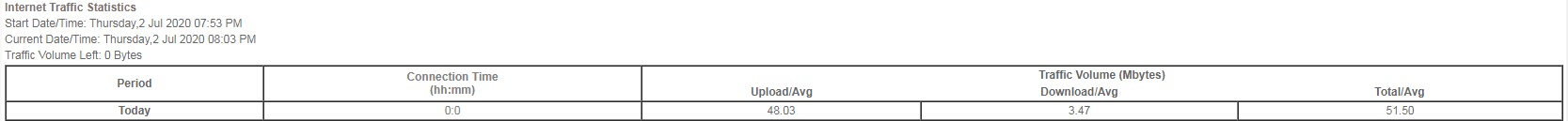

Are you able to view bandwidth info by device within the router admin tools?
With Orbi you aren’t able to view by device, just overall. I kept just the devices mentioned before connected and set a 10 minute timer to see the upload/download numbers.
Upload: 48 Mbytes Download: 3.5 Mbytes
I do, I have my old Asus AC2900. Still a decent router so this will give us a good indication I think. I will let you know when I get them all switched over.

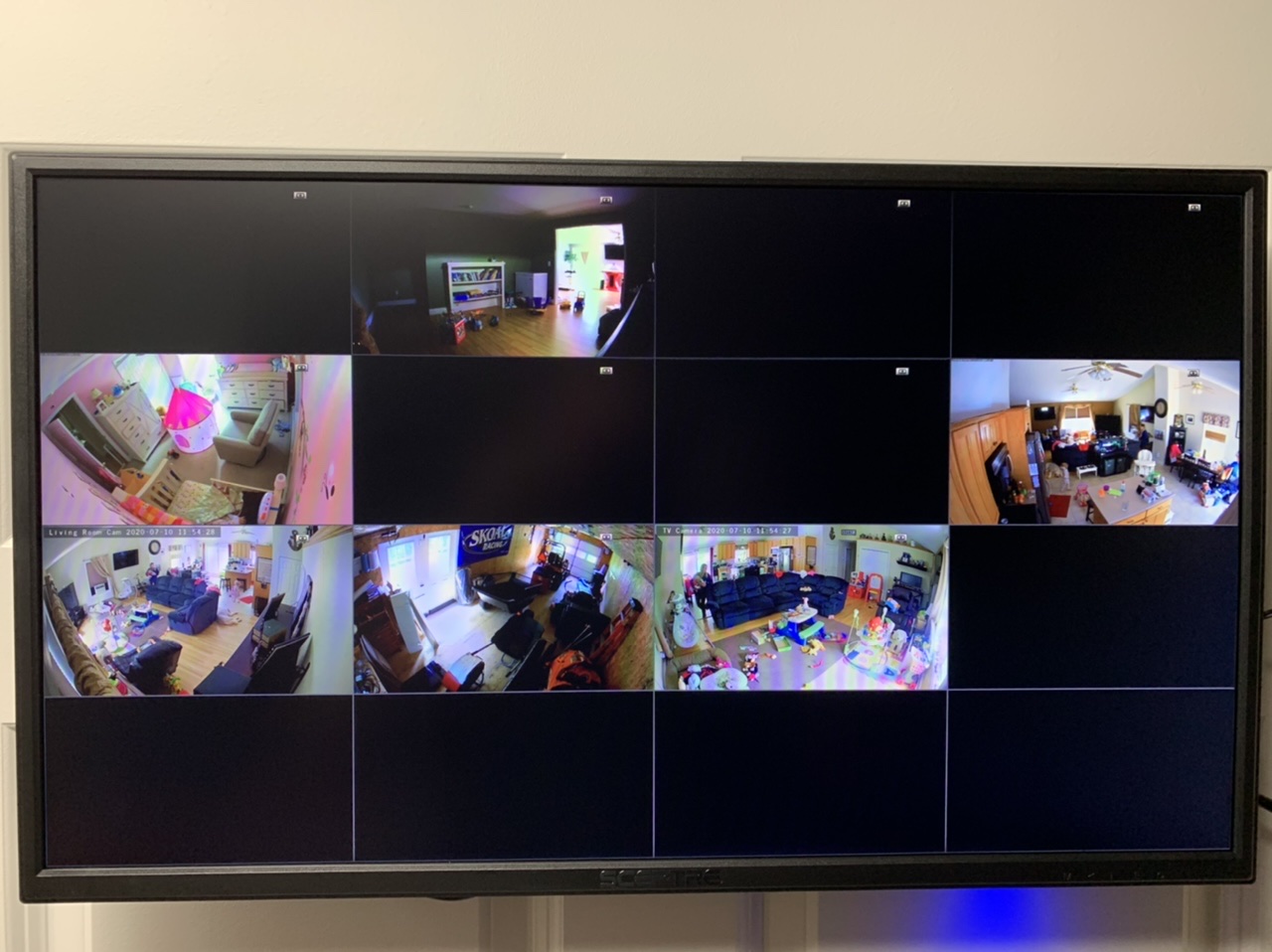

So I got all the cameras and the CSVR on the Asus router directly off the modem and the same results. 3, sometimes 4 of the cameras are just black screen. I was hoping this was the solution but at least it shows its not the Orbi system. Any ideas where to go from here?
I did expect that to resolve the issue, but I guess something stranger (or maybe simpler) is going on. Still seems like the CSVR itself, maybe its network adapter is just malfunctioning. It is supposed to be a gigabit adapter and there should be no issue with all the feeds.

Ok, So I finished putting all the cameras and svr on the .168 subnet (Orbi) since I had the same results on both routers and I would prefer not to have two wireless networks in the house. I factory reset the SVR and applied the recording setting on high to all the cameras. I have disconnected the Asus router completely to eliminate any interference issues that could arise.
At first or left alone for a day, all the cameras have an image but they are frozen. The second I click on one. It is a black screen and when I go back to the overview of all the cameras. Half of them are black.
Can you confirm which cameras are failing to connect right now? Names or channel numbers. The CSVR is reporting all streams connected, so we need to investigate the individual cameras that are not showing up on screen.
