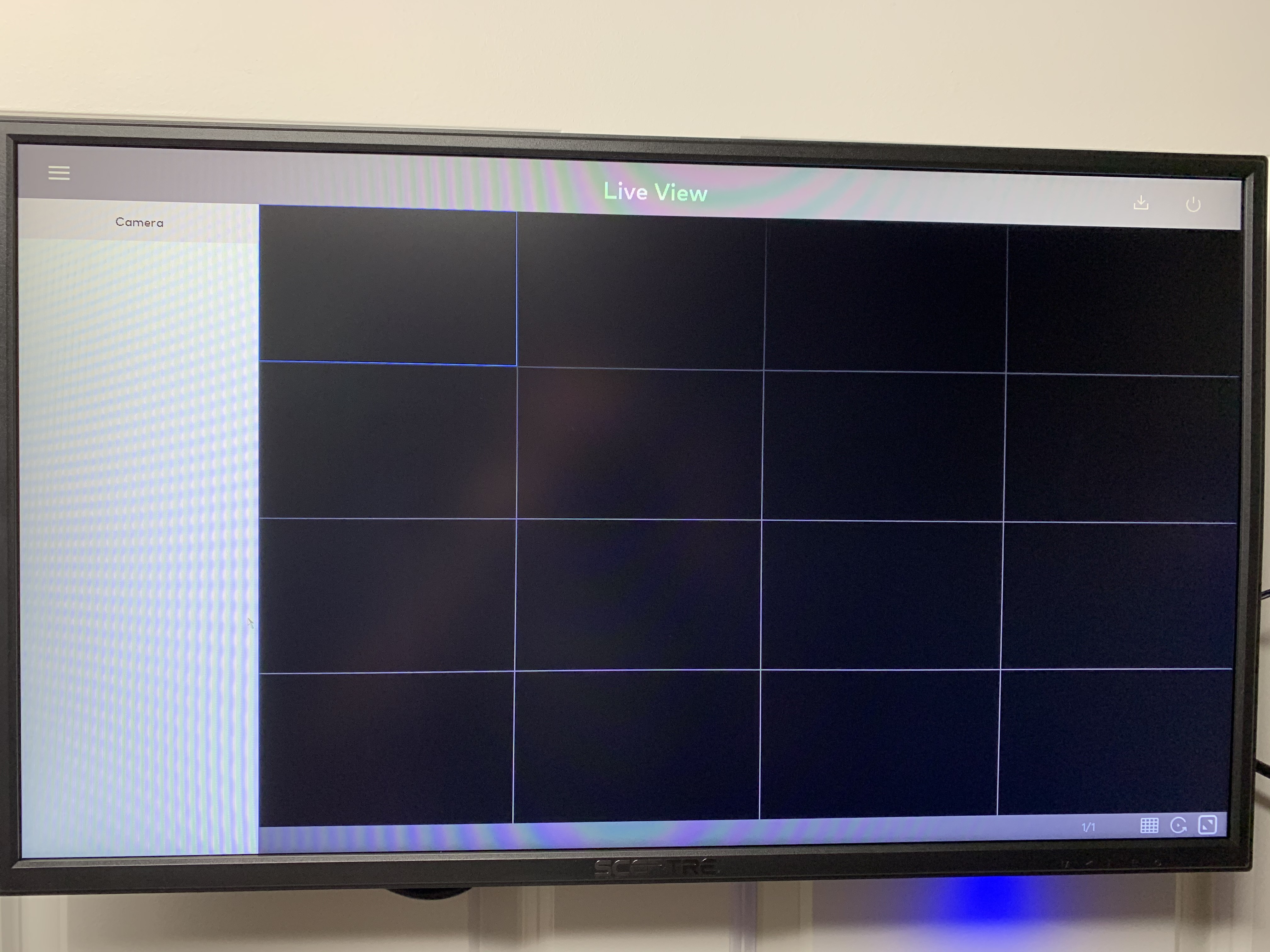

No changes, still the 4 camera are black on live view on the SVR and not able to play back from them.
I installed the CSVR two weeks ago and its been like this since the beginning. I have been trying to troubleshoot myself but haven’t got to far. I have noticed a few times, on the screen I posted with all the camera in one view, they were all visible but when I click on 1 of those 4, its just a black screen. That indicates it getting some form of connection to the camera.

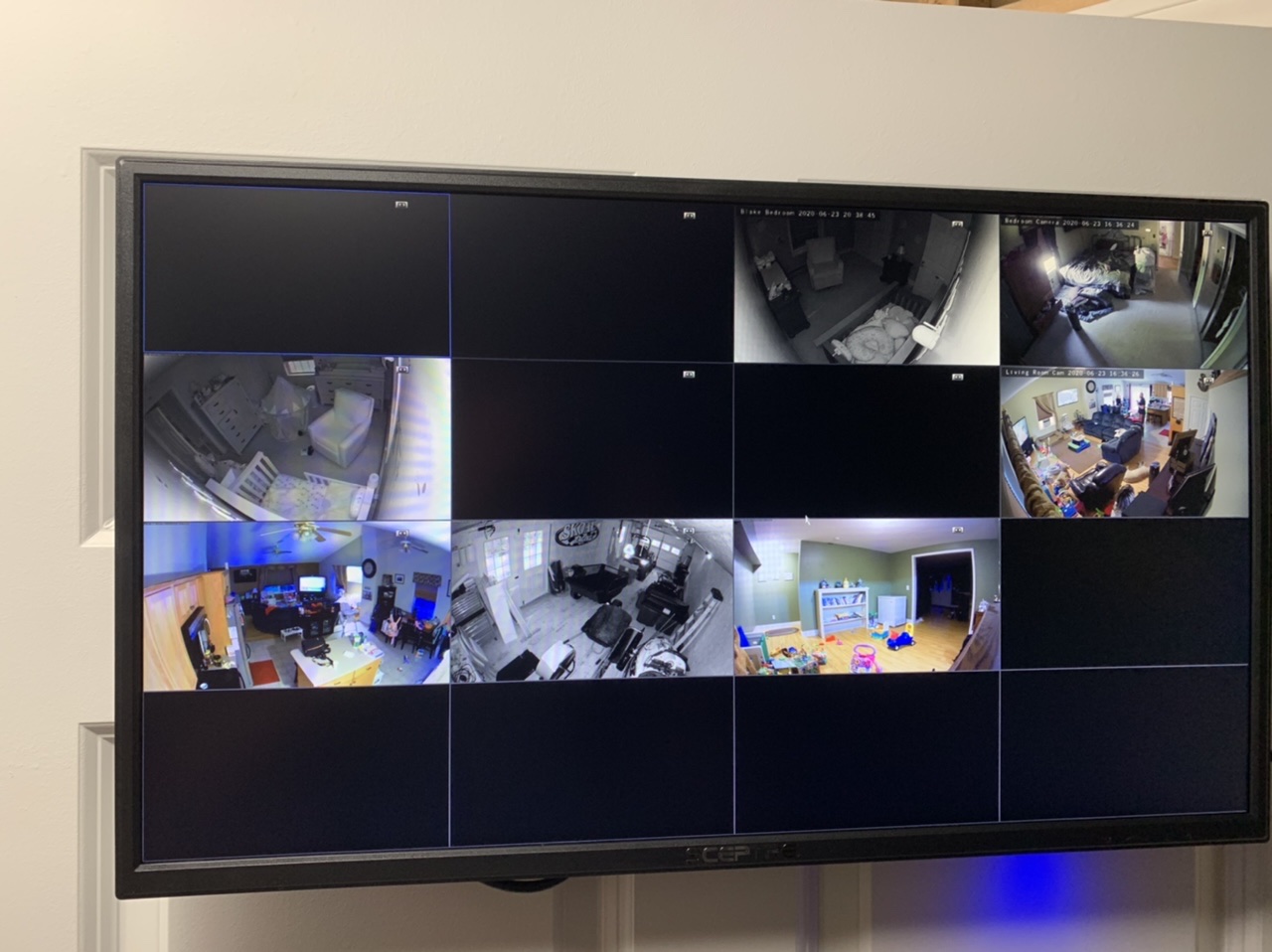

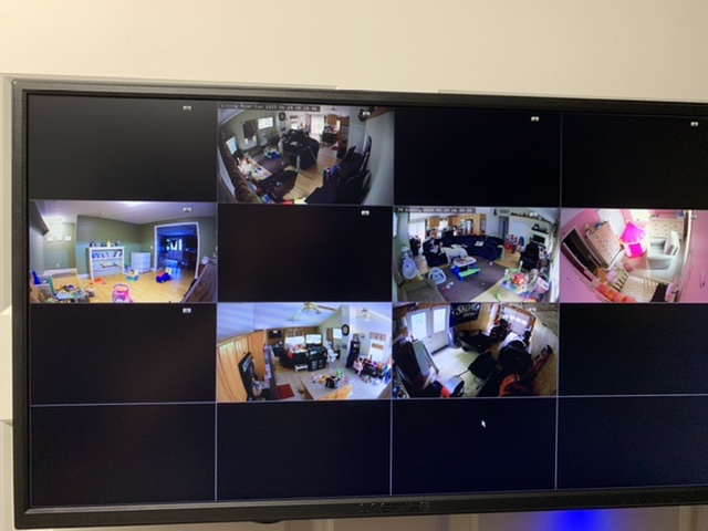

Before clicking any of the cameras to get it full screen, I noticed about half of them were frozen, the time was stopped and not moving with the ones that were working. I clicked on one the frozen ones and it was a black screen. I then went back to the view with all of them and this is what it looked like:

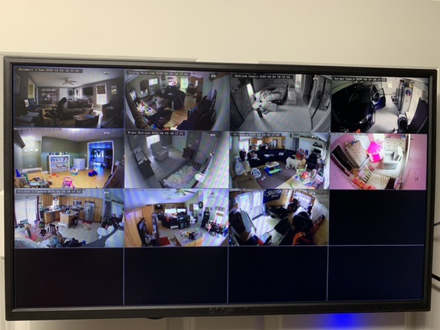

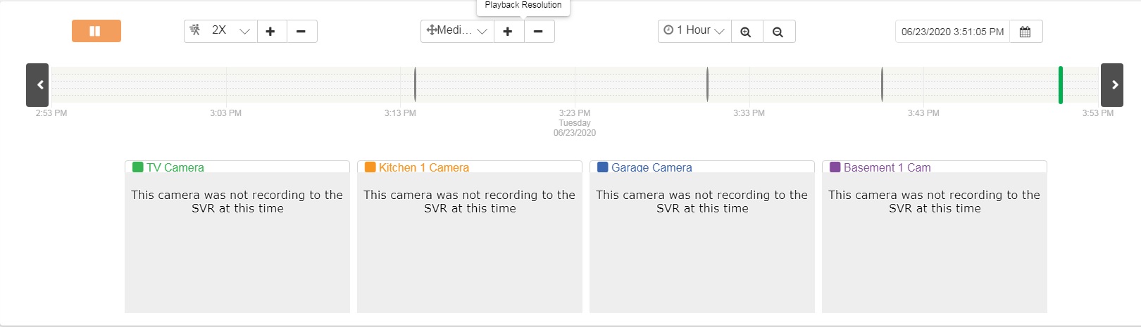

I noticed the only 4 cameras recording like they should are my older 522 cameras. One of the 523 cameras has an image but it paused but the rest of the 523/723’s are all not recording. So it seems to be an issue with the camera models. Maybe they are happy with have different types of cameras on the SVR? The older ones are only recording at 5fps where the newer models are 10fps. I’m really not sure where to go from here. Next steps to try? removing all of one model camera, the 4 that are working and see if starts recording the newer cameras?
I removed all the recording schedules from the 522 cameras and did a power cycle but no changes. Initially after booting, all the 523/723 cameras looked like they came to life but they were just frozen. Once I clicked on one, it was a black screen, then went back to the overview of them all and they were all black. I looked at the playback and they recorded for a second then nothing.

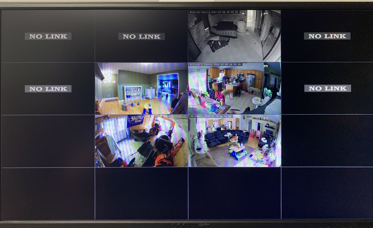

I have removed all devices from my network except for the cameras, CSVR, and my laptop and I am only getting half the cameras on the CSVR. I can view all the cameras via the app on my phone and also on the website with no issues so it doesn’t appear to be something bogging the network down or interfering with it.
