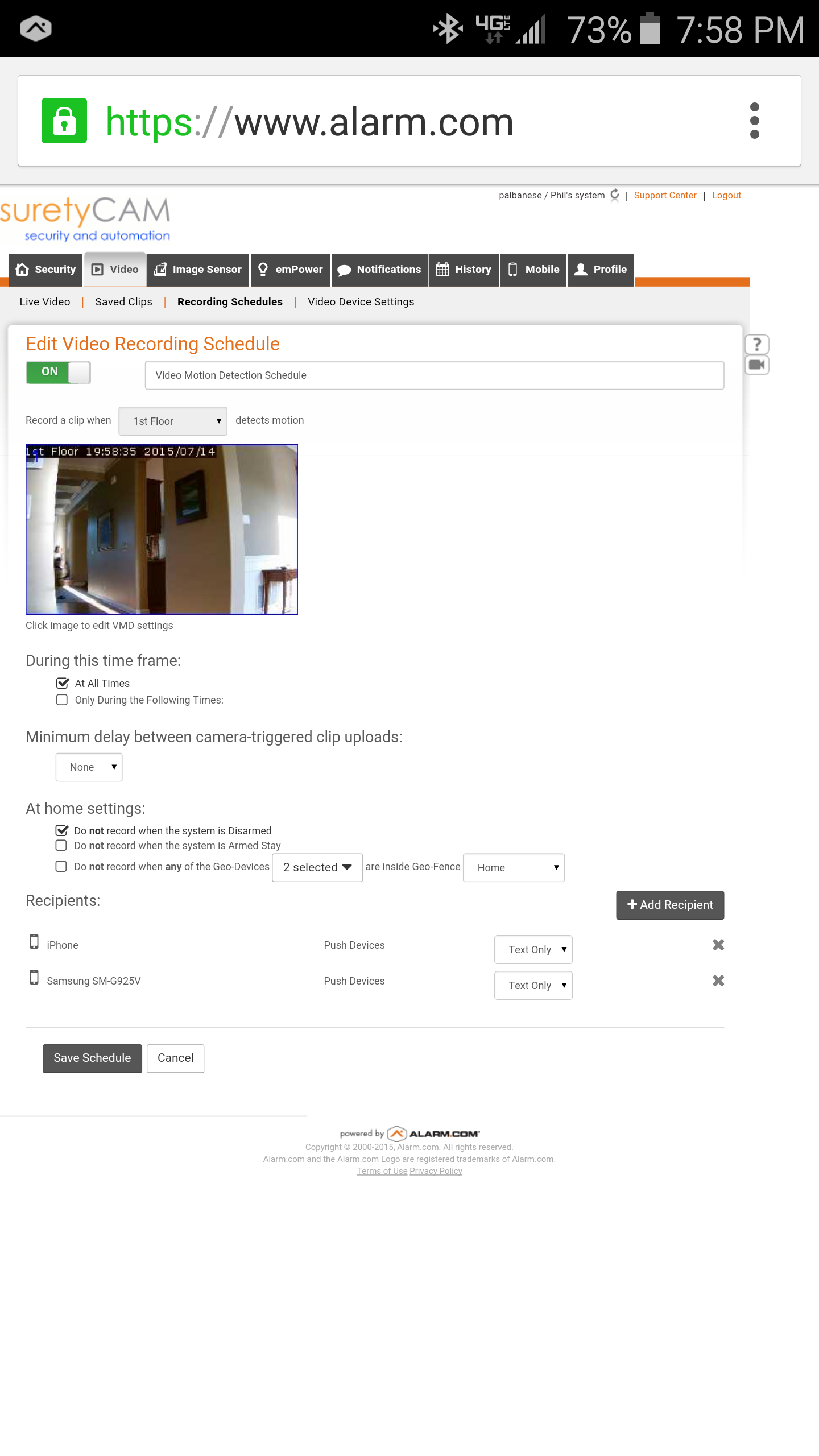

turn off all VMD rules, and see if recordings cease. Post screenshot of recording schedules.

Delete the rule, and recreate it. Check ALL “at home settings” boxes, redraw VMD windows and make them small “trip wires” I keep mine at 5 sensitivity and 10% target. Perfect VMD windows.

Edited VMD window to cover area of panel
If the VMD recordings still occur with all the at home settings checked, then something is wrong.

Yes I recently added this camera (twice as I removed and added back last night). I tried to cycle an arm / disarm as well as checked all three boxes (disarmed, stay, and geo). It still keeps recording when motion.
As a troubleshooting step, could you edit the recording schedule to record when motion is detected at specific times instead of at all times?
Uncheck At All Times.
Check Only During the Following Times: and select some times
I’m curious whether it’s ignoring recording schedules all together or if it’s just failing on the system status based settings.
