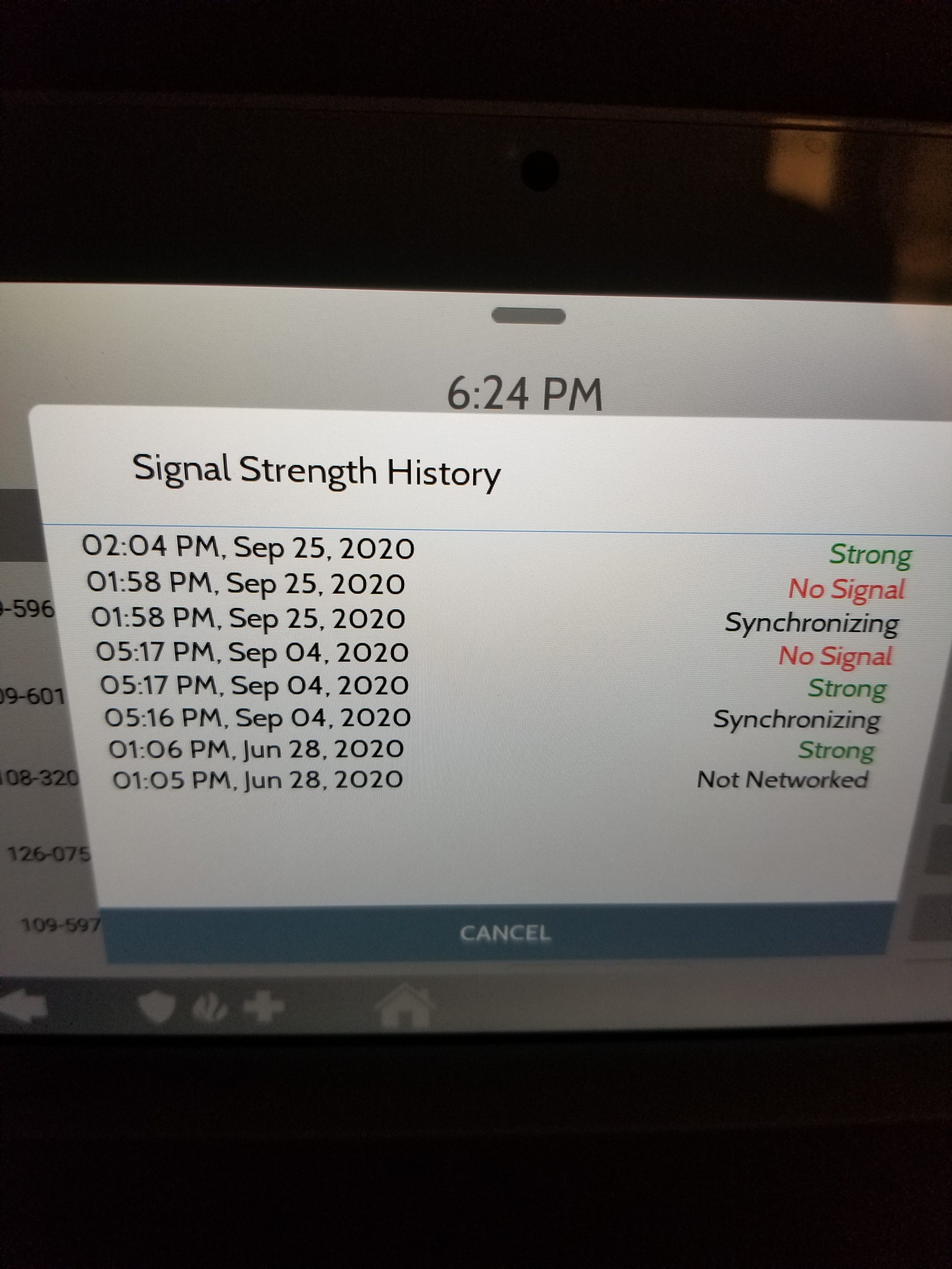

I moved the sensor up about 5ft from the ground hoping to improve signal strength. When I look at the signal history at the panel I’m not seeing anything since 10/11-- are you able to see more info on your side?

There has not been any activity since the 11th. I was more curious about signal strength reporting, which has not reported since 10/11.

Ah, I see. Yeah I was looking at sensor history to determine if it was reporting. I wouldn’t see supervision signals, just a lack of them reported by the panel, but that wasn’t the case.

So looking into this a little more I only see supervisory signals on PowerG devices only being sent every 21 days. Is there something in settings that I’ve done in error? In dealer settings I believe it’s set to report loss of supervision in 1hr.
I’m not sure where you are seeing that particular value. Supervision options for PowerG run between 20 minutes and 24 hours.
Can you post an image of what you are seeing?
Maybe I’m confusing signal strength readings with supervision. Odd that signal strength is only reporting at those intervals?
Yep, that signal strength test page is not related to supervision signals.
