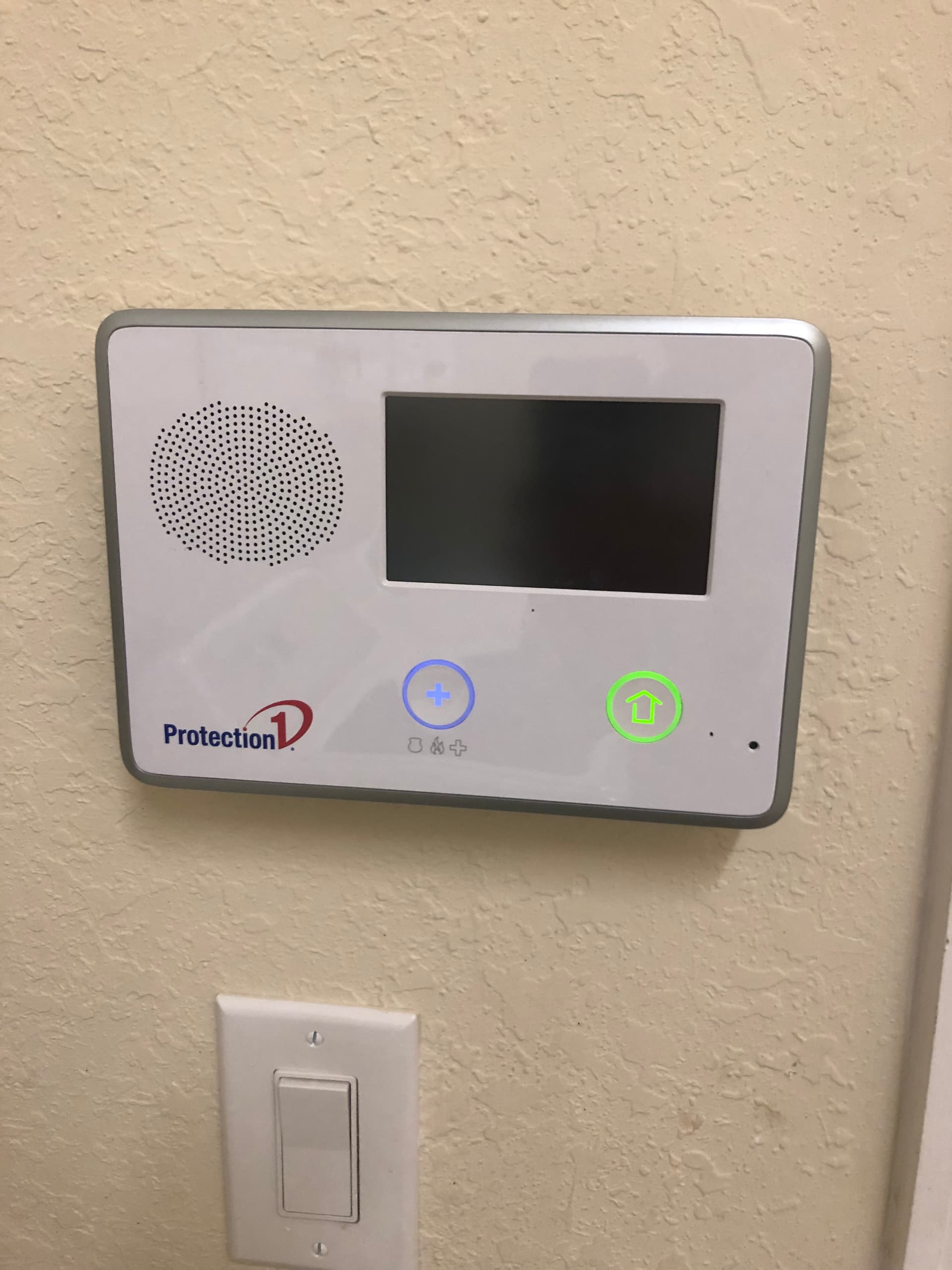

What type of battery you need will be determined by the model of panel you have. Can you confirm the model of alarm panel you have? You can post a photo if you aren’t sure the model.
I have two.
That is a 2GIG Go!Control panel, GC2.

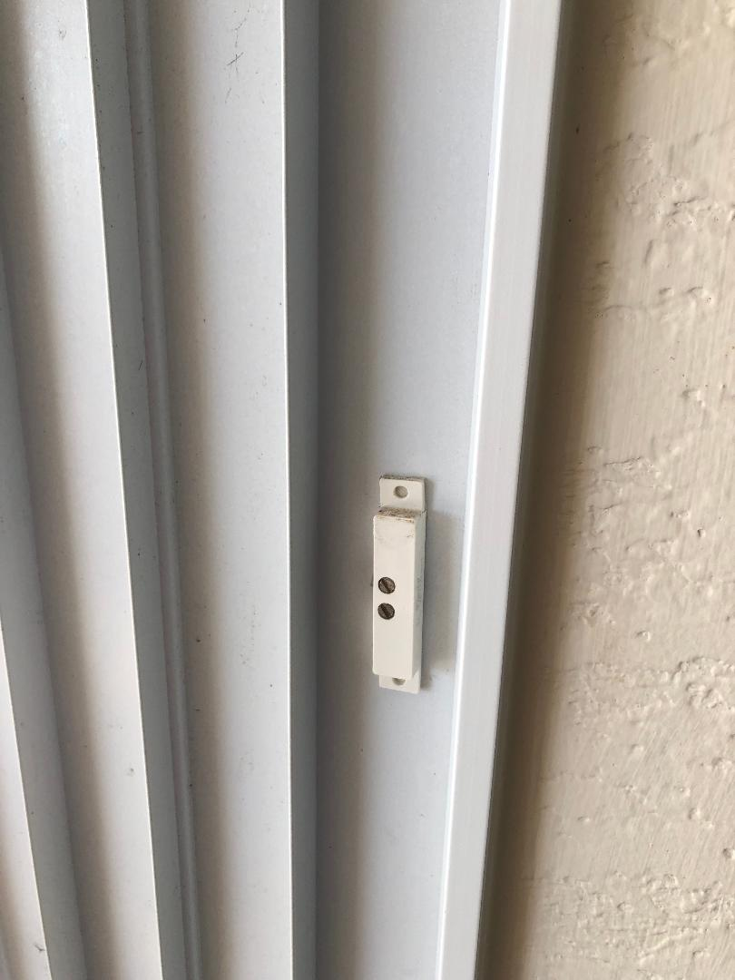

I ask because wireless sensors have batteries in them and you would need to replace the battery in each one. Wireless sensors are bigger because they have a circuit board and battery inside. They can also be opened up to see the inside.
Wired sensors are usually smaller and just have a couple wires coming out of them that run to a panel or a takeover module. They typically can’t be opened up to see the inside. In this case you would replace the battery in the takeover module.
Can you post a close up pic of 1 or a few of the sensors?
That’s a wired sensor.

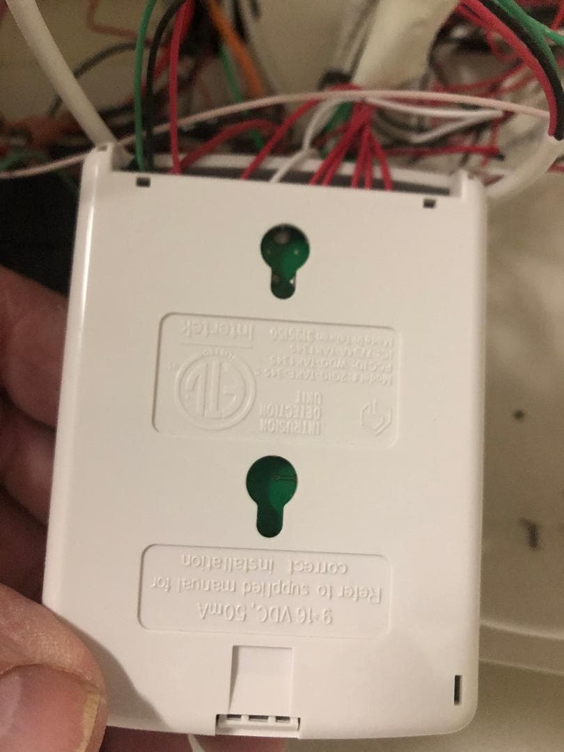

In the 2nd pick of the Concord 4 panel, it looks like that might be a 2GIG takeover module in the bottom right corner of the pic partially off the screen. Can you confirm?
If that’s the case then it would be the battery in that pic (Universal Battery AMG type) that you need to replace. The sensors themselves don’t use power or have a battery but the takeover module does.
