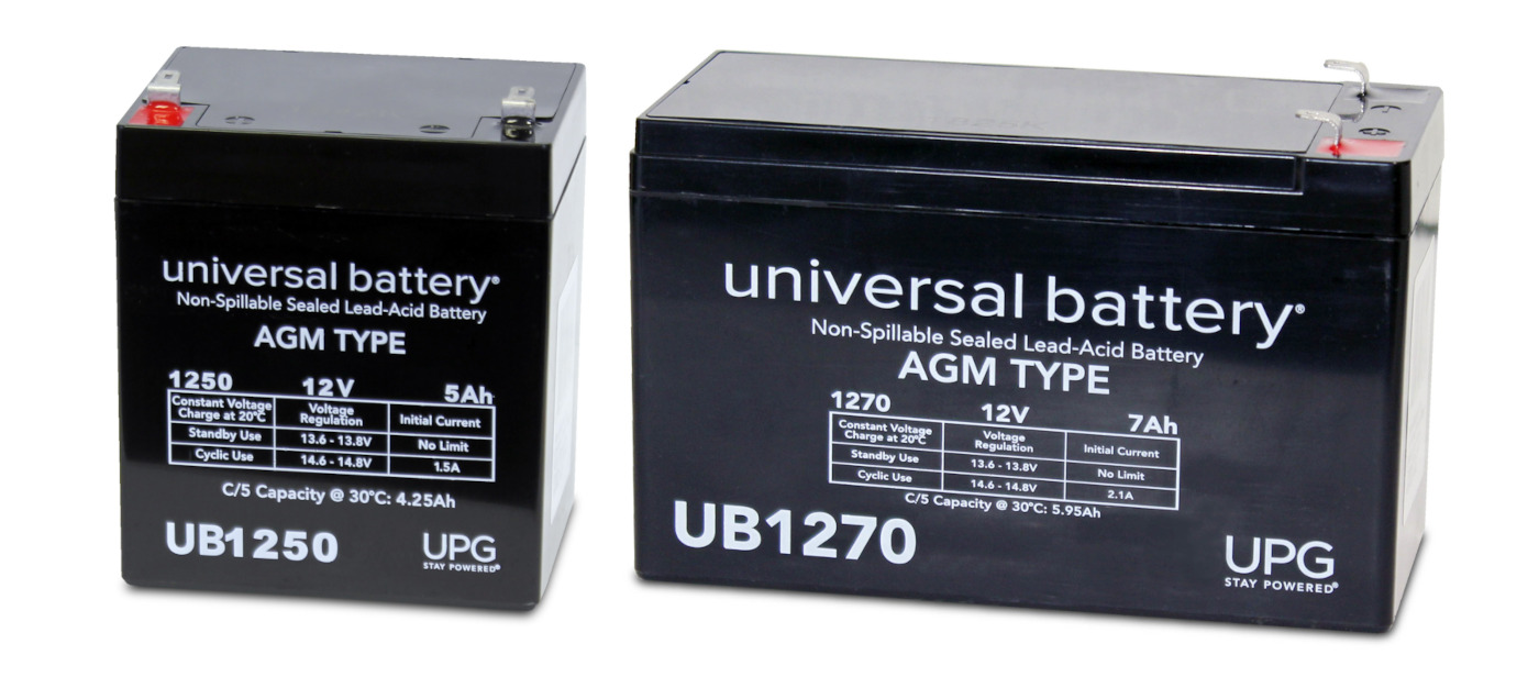

Where To Get Security Alarm Batteries
Alarm system batteries are heavy and expensive to ship, and they’re generic. As long as you’re using a battery with the right specs, it doesn’t matter which brand you use.
For these reasons, Surety doesn’t stock a variety of battery sizes. We carry a small battery and we only have one size. It’s usually easier and cheaper to get them locally, from a store near you.
Many hardware stores, big box stores, and battery stores have alarm system batteries that you can pick up locally. Some even ship to your house for free. Here are examples of stores that carry alarm system batteries.
If you’re not comfortable shopping and comparing specs, the Universal Power Group (UPG) models UB1250 and UB1270 are what we’ve used the most at Surety. But that doesn’t necessarily mean they’re better than other brands. UltraTech, Power-Sonic, EaglePicher, Sigma, and Yuasa are also popular security alarm battery brands. Mighty Max brand batteries appear to be the lowest cost and, as far as we know, work just fine.
