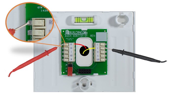

Verify wiring with a multimeter on an ADC-T2000
When checking the C, Y, Y2, G, and O/B wires:
  1. Using the red probe, touch the metal pad behind RC (or RH if that’s the connected terminal).
  2. Using the black probe, touch the metal pad behind the corresponding terminal you are testing (see Y in the diagram above).
  3. Verify that you are getting between 18-30 VAC on the multimeter.
  4. If you are getting 0 V, the RC wire is likely not connected, or the thermostat wires are not active.
  5. If you are getting something slightly greater than 0 V, the terminal you are testing is not connected properly.
  6. Remove the problem wire, re-strip, re-insert, and test again.
