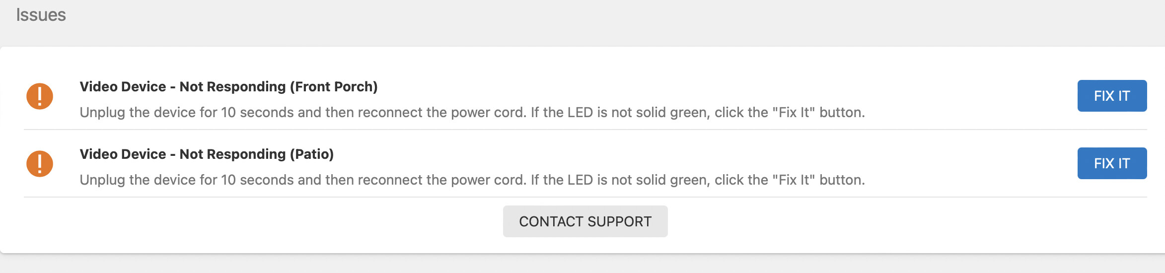

Also, after all the “work” I did in my ADC account, I keep getting this message. I followed the fix it button and it successfully resolved itself but the message keeps popping back up. Is this something on your end that you can do? Thanks,
@jwcsurety good afternoon. Not sure if you sent some sort of command on your end but my two error messages with those cameras resolve themselves. Thank you.
