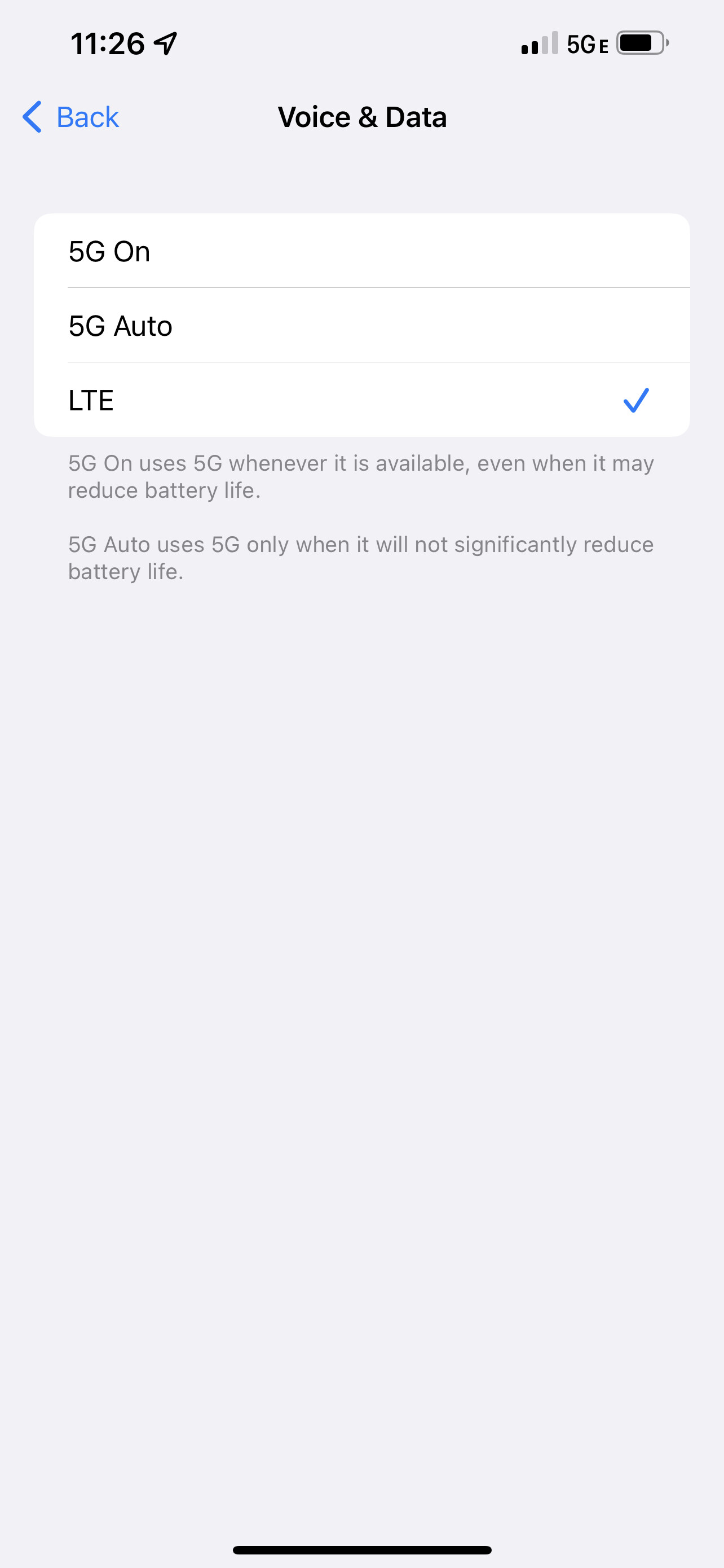

Thanks. Are you able to force that phone onto 4G LTE instead of 5G as a test? Any difference?
