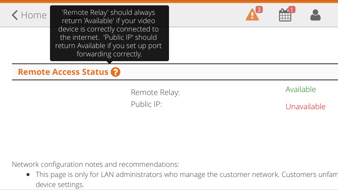

Apparently I am currently using “DHCP” which is some kind of auto IP address something or another? I ran the remote access test and the “remote relay” says “available” which is good. The “Public IP” says “unavailable” which I’m assuming is not so good. I’m sure I sound rather elementary right about now. So it says that maybe I should have setup a static IP address for this camera? Is this correct? It then goes on to say that only “networking experts” should try this. Well that rules me out. Lol. Can anyone walk me through setting up a static IP? Can Surety do it remotely? Or am I completely on the wrong track here? Thanks.

If you think your private/internal IP address is changing and that’s causing the problem then you can try setting up a static IP address within your network. How you would do it depends on your router. Often routers have a feature called DHCP address reservation that gives you the benefits of a static address (that it will never change) with DHCP so you don’t have to deal with the hassle of setting up a static address.

Most people don’t have to setup static IP addresses or port forward to use Alarm.com cameras but it’s possible that you might on your network.

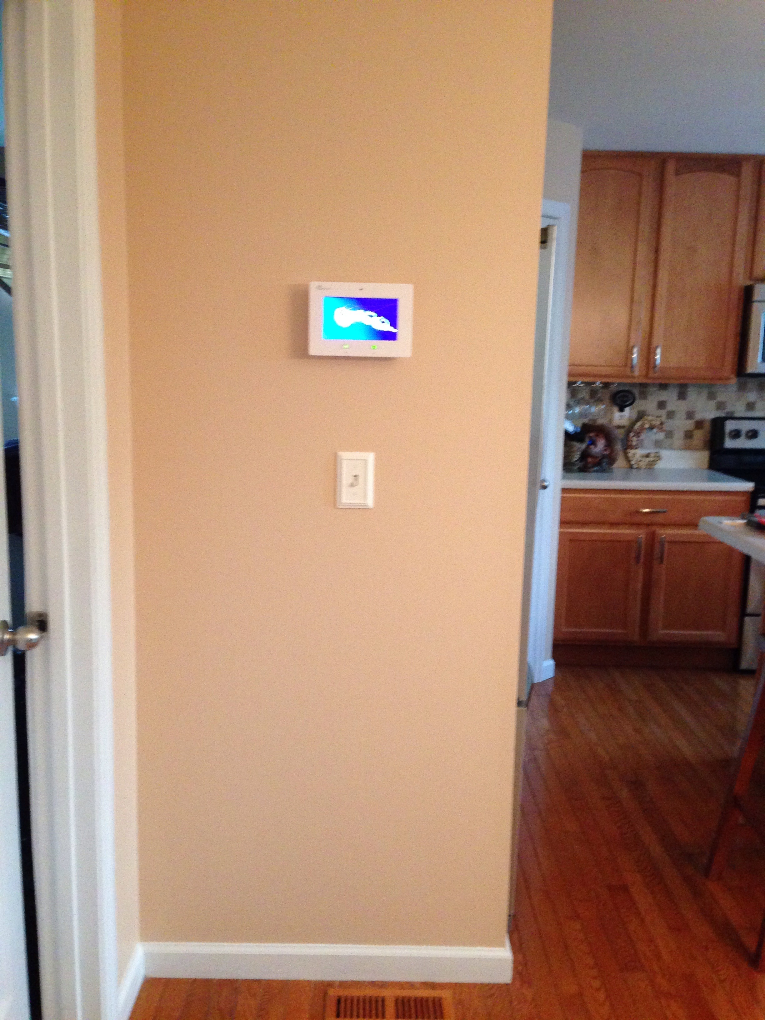

On a brighter note, somehow between working 12 hour shifts and troubleshooting the V520ir, I was able to finally stop playing with the IQ panel and actually get it mounted today. I’ll attach a pic. Turned out nice and clean.
