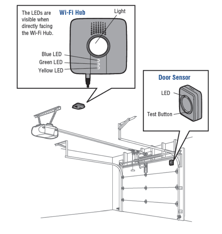

To program the garage door opener to the 821LM:
Important : Use the results from programming the door sensor to the 821LM to determine if the 1 or 2 button needs to be pressed to program the garage door opener.
- Press and release the Gear Button (Settings), the Blue LED turns on solid.
- Press and hold the Gear Button again until the Green and Yellow LEDs alternate blinking.
- Press and release theGear Button again, the Yellow LED turns on solid.
- Depending on which slot the garage door opener is being programmed into, press and release the [1] or [2] button the number of times indicated in the following chart. Then the Yellow LED turns on solid.
- Press and release the Gear Button. The Yellow and Green LEDs blink.
- Press and release the Learn button on the garage door opener.
- Depending on which slot the garage door opener is being programmed into, press and release the [1] or [ 2] button until the garage door opener clicks.
- Depending on which slot the garage door opener is being programmed into, press and release the [1] or [ 2] button again to activate the garage door opener.
- If the garage door opener does not activate, press and release the Gear Button , then repeat steps 3-8.
- Once the garage door activates, exit programming mode. To exit programming mode, press and hold the Gear Button until either the Blue LED blinks if Wi-Fi is not set up, or the Green LED turns on if Wi-Fi has already been connected.
