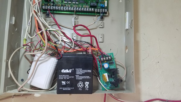

Here’s a pic of my system the red wire that loops up then down comes from the transformer, that is plugged to a working receptacle, then goes to the circuit board next to the brick battery, it then exits board and connects to the battery.

Where is the 2GIG Panel powered? There should be a white transformer plugged in powering the 2GIG Go!Control Panel.
Could you post a close-up photo of the old panel board power terminals and another of the device in the bottom right corner?
I’m not seeing where the power is coming from, it looks like only one pair of conductors is connected to the old panel board.

It appears that the 12v brick battery is likely low or disconnected. In order to better assist please post close up images of the old panel board power terminals and another of the device in the bottom right corner of the image you posted earlier in the thread.
