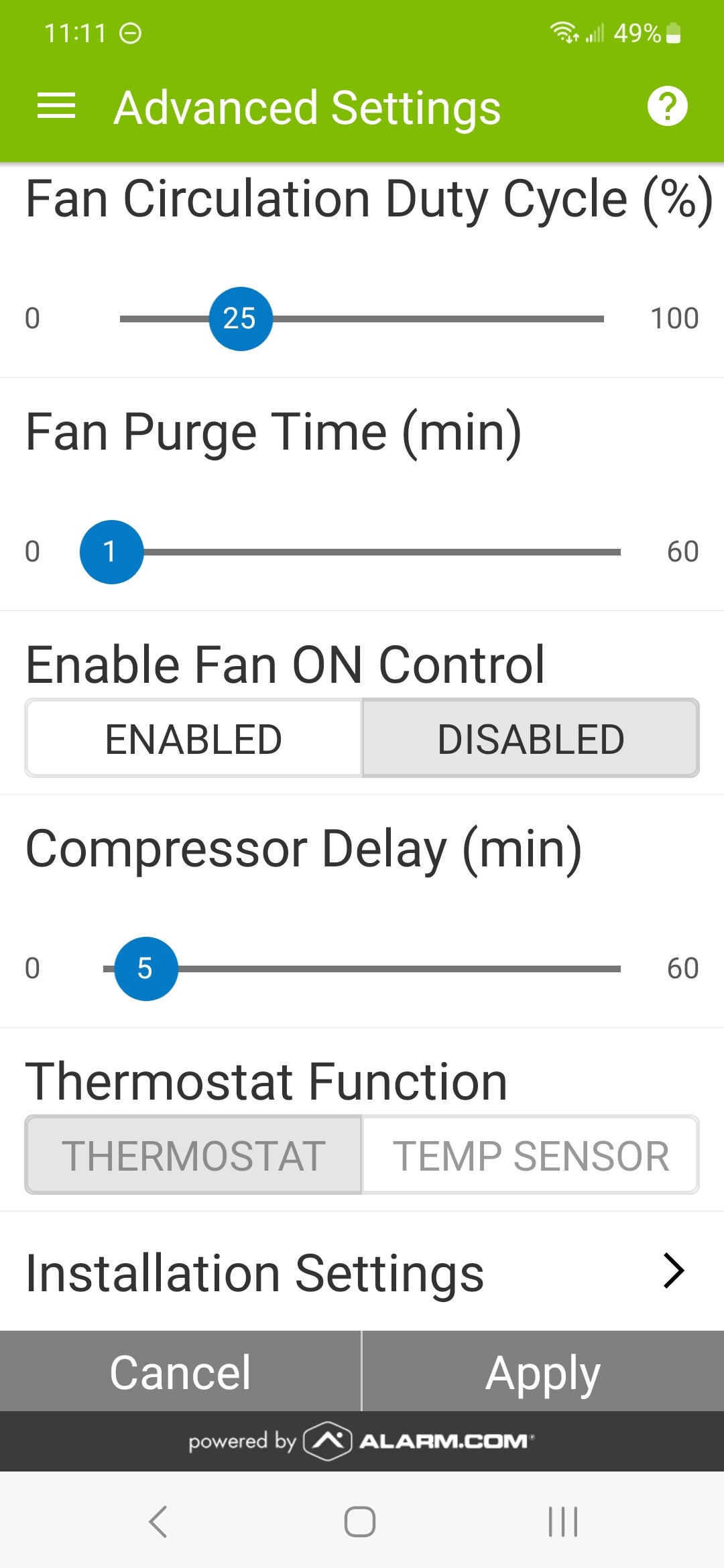

Hello, I have a t3000 thermostat and a s2000 temp sensor. The temp sensor never works 100%, the temp will be higher and until I hit the button on the side it then updates and triggers the thermostat to kick on. So I found an old t2000 thermostat and see a setting under advanced to set as a temp sensor or thermostat but its grayed out. Can you switch it on your side? Also one more thing, I used to be able to say use the temp sensor at 8pm vs the thermostat or both on a schedule. I noticed thats gone now. Can you confirm adc makes it only the thermostat runs the schedule now?
Thermostat Function is not a supported feature it appears. This may be a holdover from a previous feature that is no longer supported or a feature that may be supported in the future but there is no information about it at this time.
