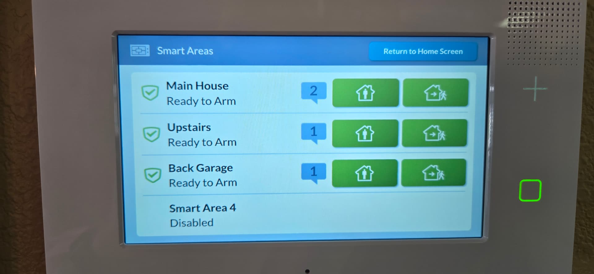

I can’t thank you enough for your help. I am not seeing a flashing message alert icon on the home screen, The “Smart Area” button should be blue when all is okay, it is yellow, meaning there is an error message (trouble alert) in the partitions.
It was originally beeping and flashing until the alert was acknowledged, then it stopped beeping but the message bubble remained in the partitions.
I have attached pictures of my home screen with the yellow “smart areas” button, the smart area home screen with a list of each of my partitions along with the message bubble and each of the message bubble messages when I open them.

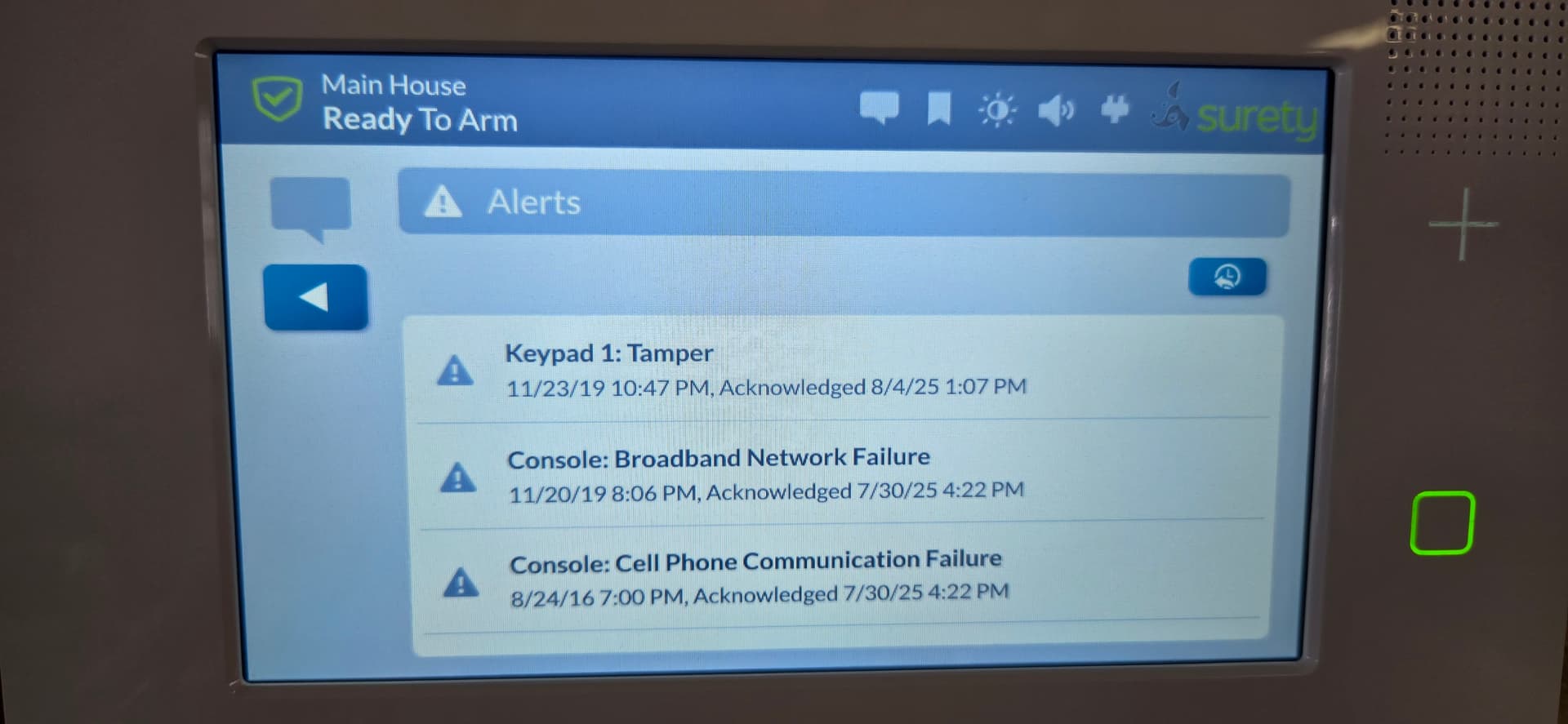

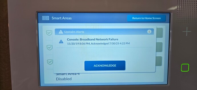

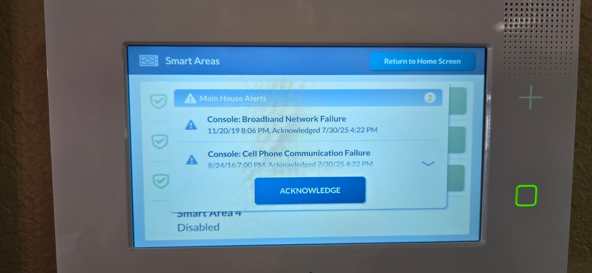

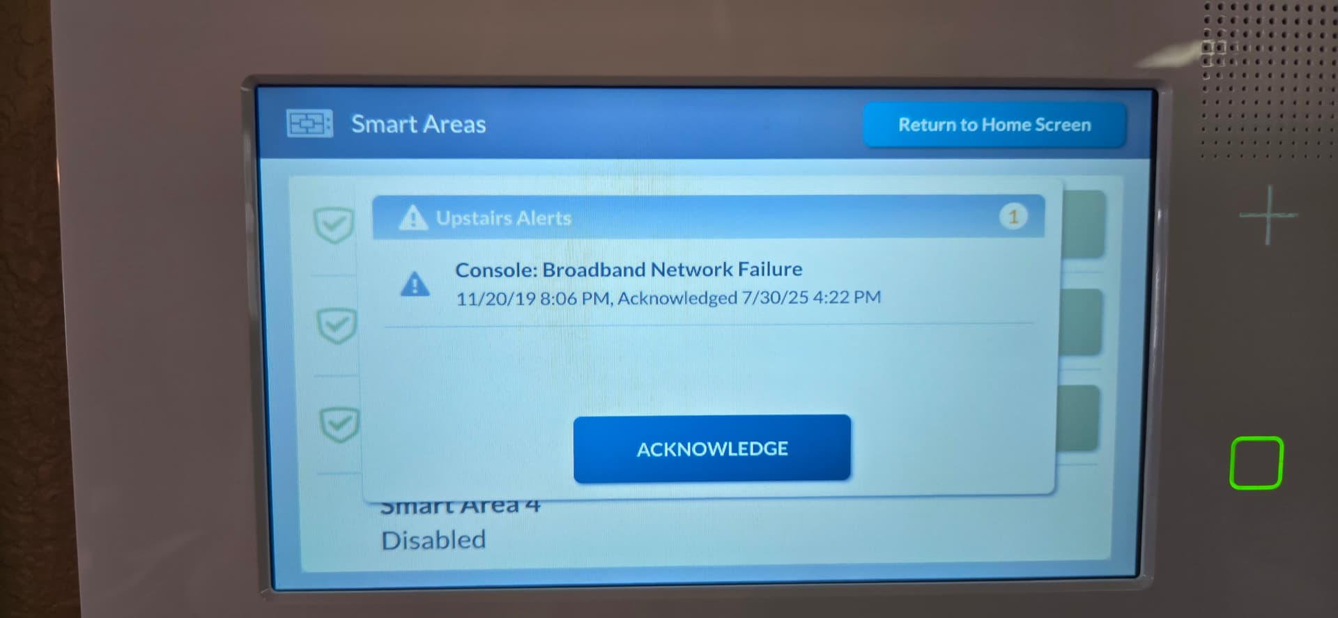

Tyler, thanks for your reply. Yes, the battery absent did clear some time after replacing the battery. As mentioned, the errors that still show are…
If I do the same from the smart areas, I get…
From the two areas besides the main house, I get…
I suspect the panel will alert again in just a bit less than an hour, since it seems to re-alarm every 4 hours. I’ll do the same as above prior to acknowledging the trouble (if it allows me to).
