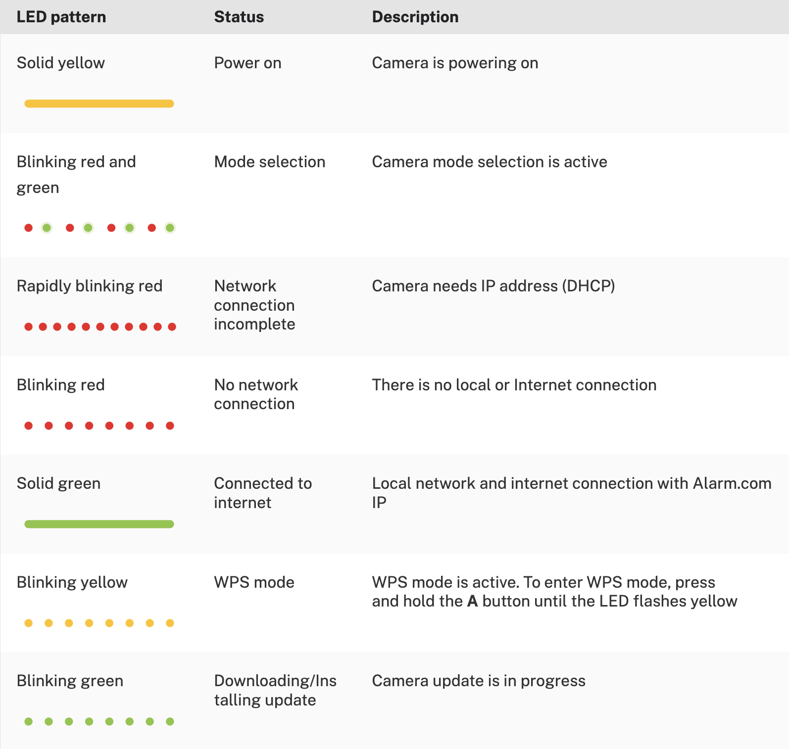

There should be an LED on the camera that will indicate its status. What color is it? Is it blinking or solid?
I just keeps reverting back to blinking red after it tries to get through the setup process
I’m trying it again and I’m also gonna use a new cord and it’s still blinking red
Blinking red might mean it can’t connect to WiFi.

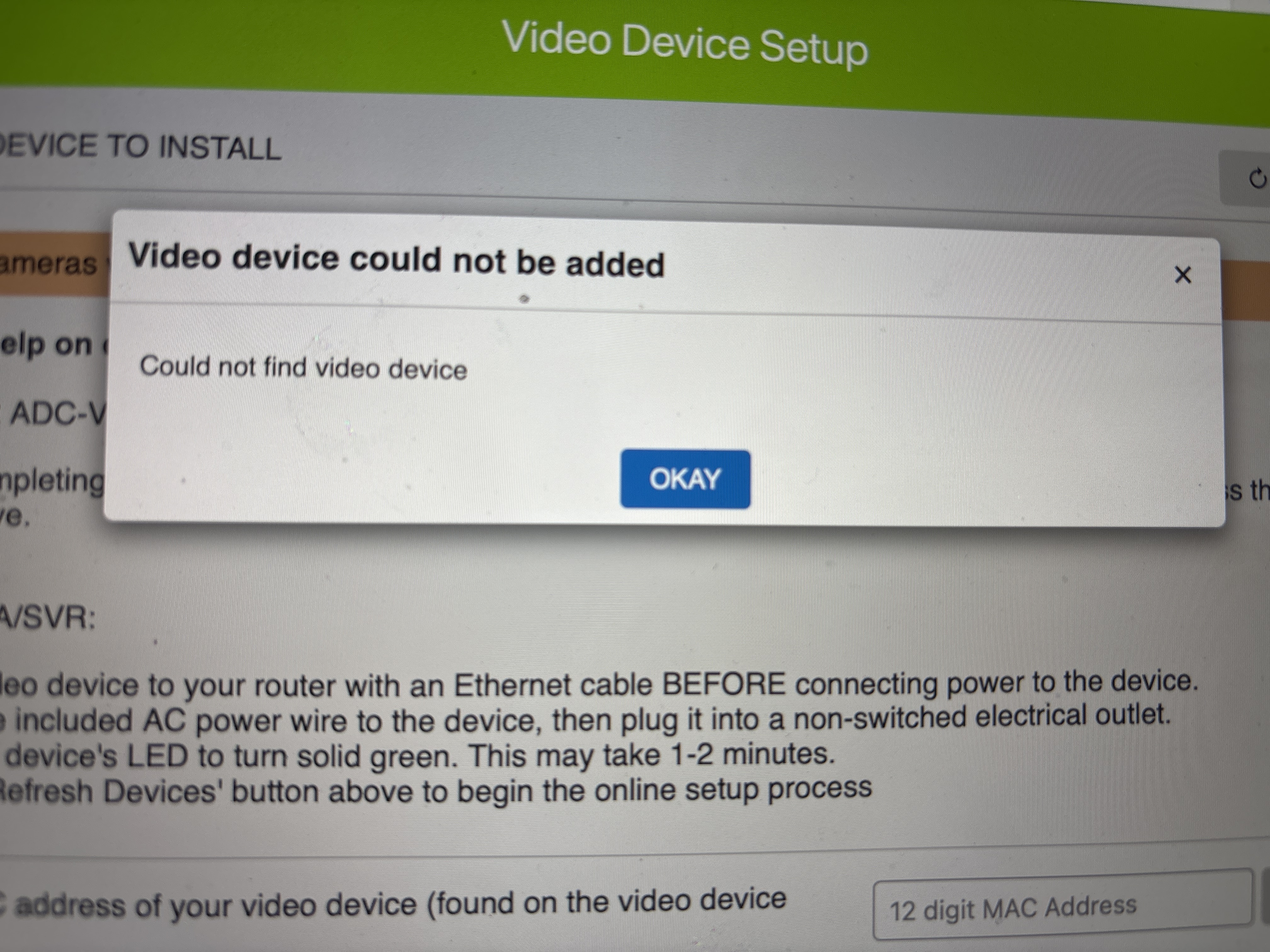

I’ve even tried WSP and ethernet, but it still won’t work and this is the message I get on my laptop
The next step I would try is resetting the camera to factory defaults.

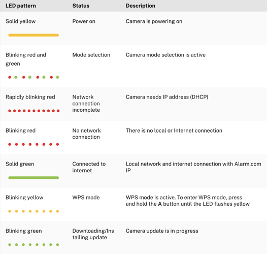

Is it blinking red rapidly or slowly?
It’s rapidly blinking red
Rapidly blinking red indicates that the camera can’t get an IP address from the DHCP server in your router. Given that you’ve tried wired ethernet, I suspect the problem is with your router settings. It doesn’t seem to be letting the camera connect to the network and assigning it an IP address.
Just about all routers have DHCP enabled by default. Is there any chance you manually manage your network and assign IP addresses to devices? That would be unusual but possible.
If it’s slow blinking red that just means it can’t connect to the network at all.
