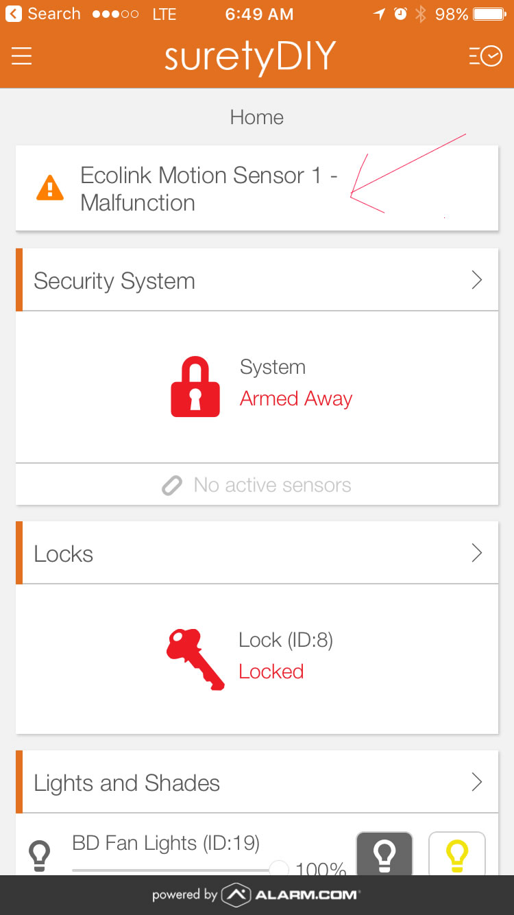

I have a zwavwe Ecolink Motion Sensor detector that I use to automatically turn on lights, but for some reason the 2GIG panel is seeing it and thinking it is a motion sensor that it should be able to use. I put it on zone two I believe even though I do not have anything on zone 2 configured on the panel.
Any way to remove it from the panel without excluding it from my zwave network or perhaps some way to configure the panel to not throw an alert about it not working?

I have marked zone 2 as ununsed. I understand the z-wave motion sensors are not compatible with the 2GIG panel and I do not want the write alarm.com (emPower) rules around the z-wave motion, however I do need the z-wave motion sensor to be part of my z-wave network (smartthings hub/primary contoller - 2GIG panel/secondary controller) so that I can use the rules engine in smartthings to control z-wave device when motion is detected on the z-wave motion sensor. I have all this working however the 2GIG panel and the alarm.com app/website shows warning messages (see pictures) that is has failed or malfunctioned. While these messages cause no harm, they are annoying.

The error you see in the first and fourth image are regarding the Sensor Programming Zone which is incorrectly set up to try to use the Ecolink (which will not work). That Zone must be deleted. Equipment update requests on our end still show that zone as active. To remove a sensor zone please follow this video:

The Alarm.com errors you see are specific to and only refer to the Sensor Zone Programming which needs to be changed.

I marked zone 2 as unused and that fixed the errors on the alarm.com website.
