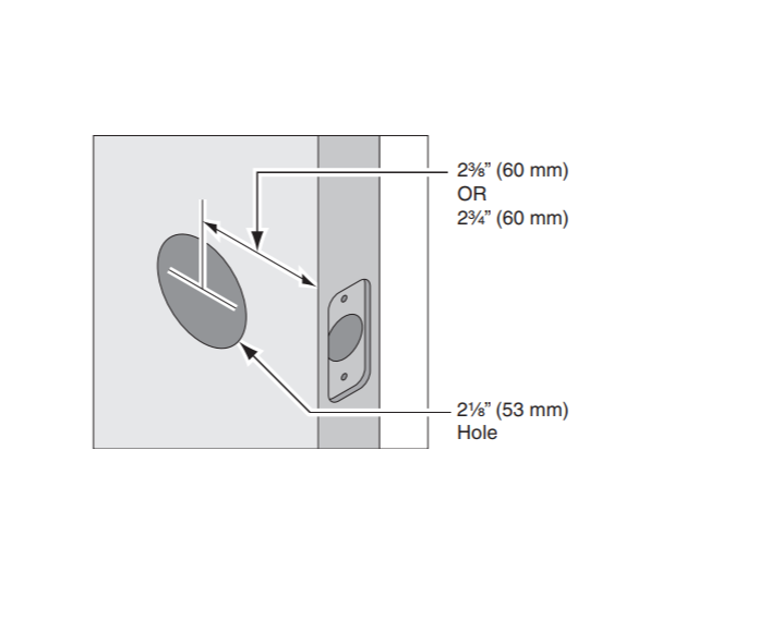

In this case any Z-wave lock installation would require modification to the door.

“In this case any Z-wave lock installation would require modification to the door.”
What do you mean by this?

“In this case any Z-wave lock installation would require modification to the door.”What do you mean by this?
All Z-wave door locks would require standard hardware cut-out dimensions. See the attached image.
Adding a deadbolt would require prepping the door and frame for the deadbolt, cutting out the holes and bolt pass-through, and chiseling out for the bolt and strike plate.
Swapping the handle may require more custom modification depending on what is behind that existing handle lock.
