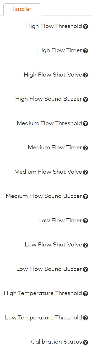

Also the blog for the SWM150 says it “automatically” detects a leak and shuts down if you’re away…but will let it go if your home (like a long shower) but how is that configured for the limits? I read only the dealer can see those limits?

Water Management Plus would need to be added by your current Alarm.com service provider.
Water Management Plus was created by ADC specifically for the SWM150 and its features. Both Water Management and Water Management Plus are required for that device. Your dealer may or may not support these features.
Thanks! This helps currently I have a very good local dealer but the valve/meter is new to him so we tend to work together for him to learn the new stuff. I do think it’s odd the Home Owner does not have access to the thresholds and settings…wonder why they did that.
