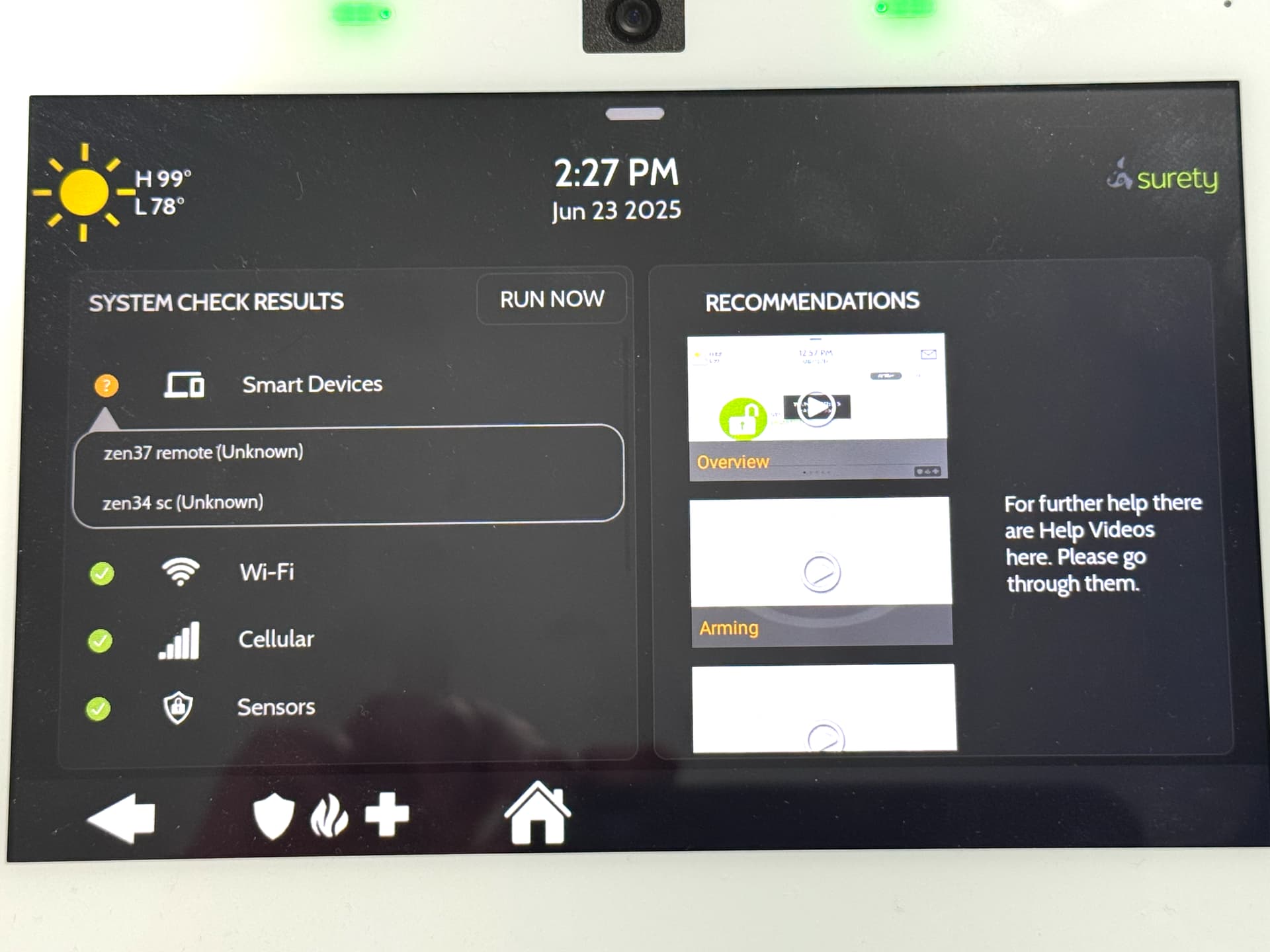

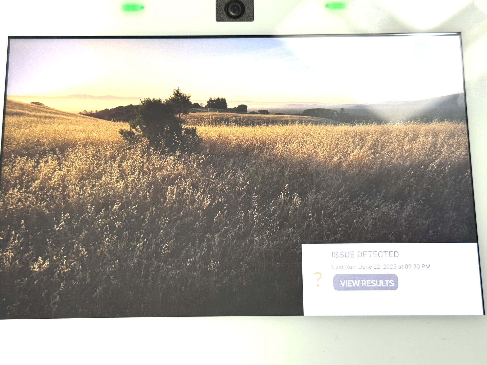

This issue happens with both the ZEN37 and ZEN34. The error comes up immediately upon adding to the IQ 4 and never goes away.
I’ve installed them on my test panel to show you the errors.
Here are screenshots of the “Issue Detected” warning on the screensaver, and the error code on the “View Results” page:
